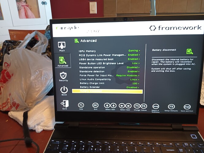

A few months ago, I contacted support because my battery was showing around 60% battery health. However, it seems that since then, it has consistently dropped to around 60% for a day or so, then returned to around 90%-99% for several days to a few weeks. I haven’t said anything about it to support because I don’t want to seem rude or annoying. What should I do?
Here’s where it is at right now:
This is a screenshot taken after charging up the battery:
You should stop worrying about a number in a list. If your run time is fine, so is the battery.
Granted, but during the times that the battery health is below 70%, the battery life gets cut almost in half (in time to empty numbers) This is going to affect me as I’m going back to college and need it to last until my night time classes and I’ll have it active 3+ hours before then and I get about 4 hours battery life under load
Do you have the charge limit or battery saver enabled?
No
The voltage is too low, continue charging for at least 3 hours and see if that works
OK, I will
So, I left it plugged in all night at it did go back to normal, but I fear that it will go back down to around 60% health again and half the battery life like it does every few weeks or so (sometimes less). I’ll keep monitoring it to let you guys know, but for now, it’s back to normal and battery life is back up to 4 hours which is 1 hour more than the average 3 I need each day before I can charge (I’m just on the go a lot I guess).
