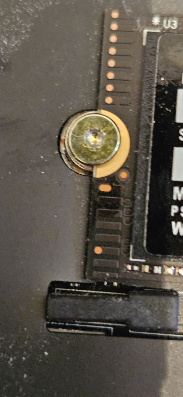

The primary SSD was only installed; I never unscrewed the screw after the initial assembly, which I don’t recall having any problems with, as the screw had reached its limit. Now I’ve purchased a secondary SSD to add, but I’ve had to give up because I couldn’t find a way to apply enough torque to unscrew the screw. While this would have been a good point, it didn’t solve the problem of the screw being unusable anyway.
I’ve read previous topics, but none of them clearly indicated a solution other than a complete system replacement, which doesn’t mean I’ll have to remove the SSD anyway :sweat_smile:
Best regards
I’ve added a couple of photos, the motherboard is from a Ryzen 7 7840HS Gen2

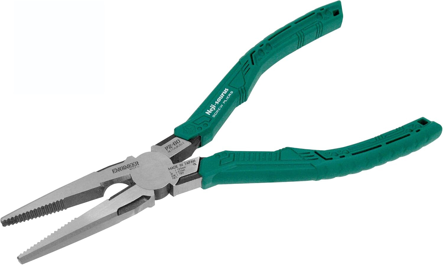

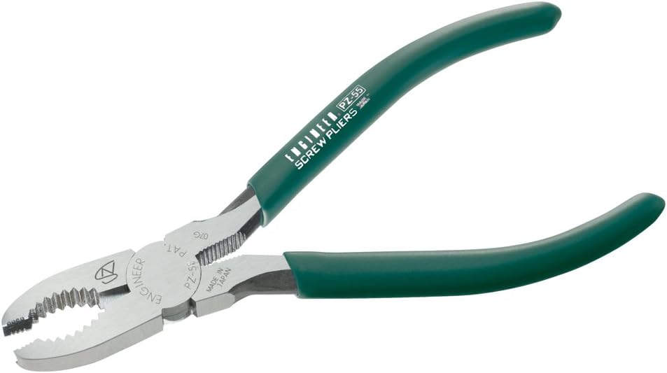

Would this sort of tool help?
Pliers curved specifically to help remove screws.

the Japanese Screw Removal Pliers Won!
As you can imagine, the screw didn’t even reach the first knurling, but I managed to get it to grip, and by turning it a few degrees at a time, I was able to remove it. In the meantime, I had also purchased a set of replacement screws from the Framework shop, which were a godsend.
