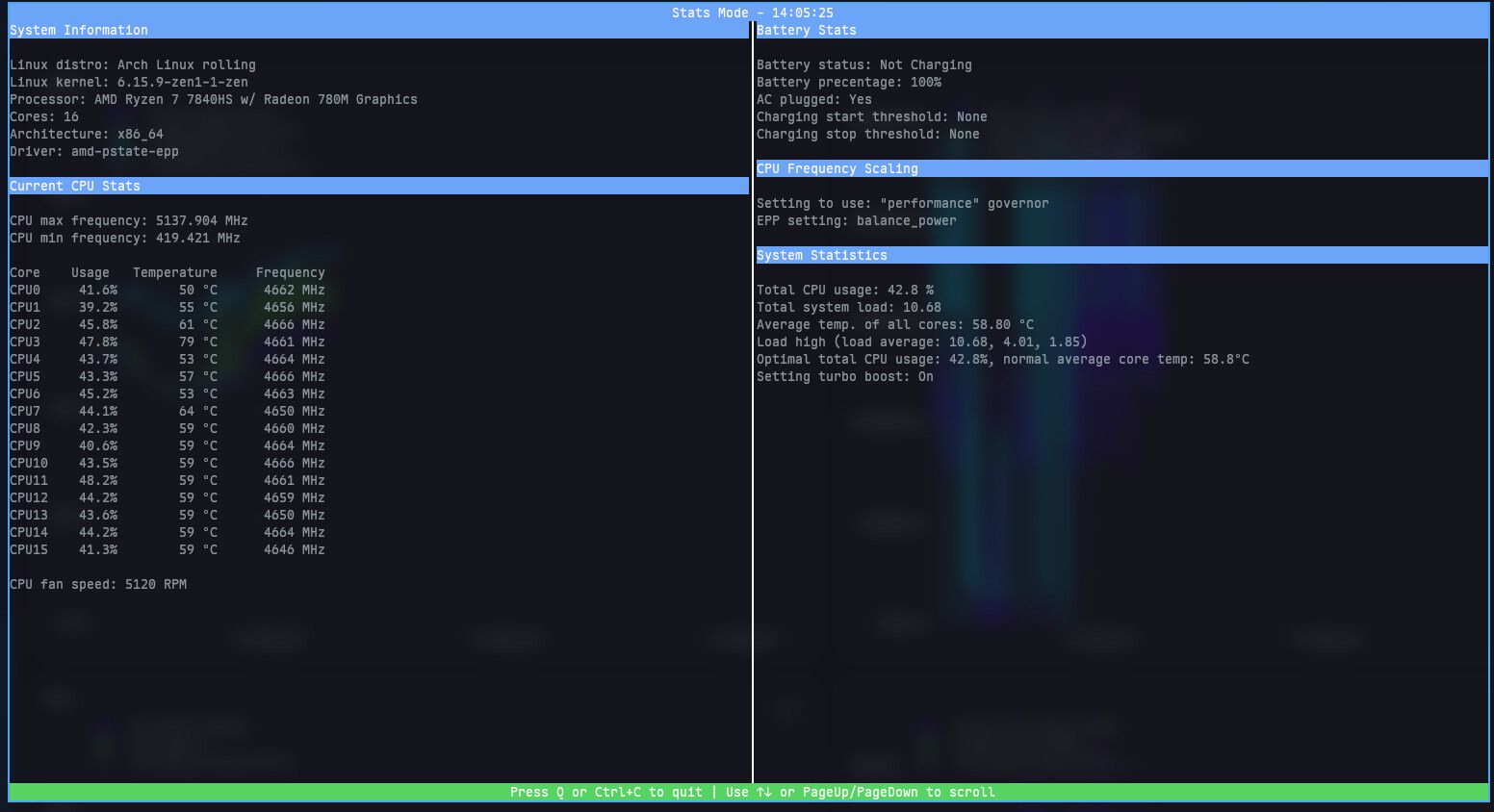

Why didn’t you post what your CPU clocks are at?
Here’s what I have right now.
Also, this is what it looks like when performance starts to suffer. Something is changing in the power management I think. But it’s still not clear what triggers it. Performance was fine for about 10 minutes and then power draw dropped and it looks like VRAM started cycling through various power states.
