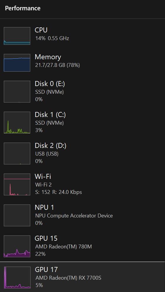

after playing hd2 for about 2 hours and then i left for lunch but when i came back it is back to running at 15 fps even after messing around in device manager. i have also been getting random spikes in gpu usage when my computer is just using a web browser. here is a screenshot of the taskmanager graph

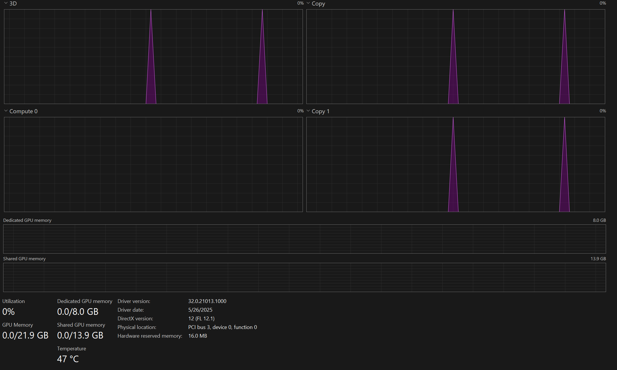

so, when i try to stress the system (hd2 on max graphics settings) my game runs like shit. but when i look at the performance charts on taskmanager i dont see the system under stress. i see a spike in GPU usage when i first launch the game but that then fades off and the chart looks like this.
but despite there being significantly more recourses available, the game refuses to use them.
