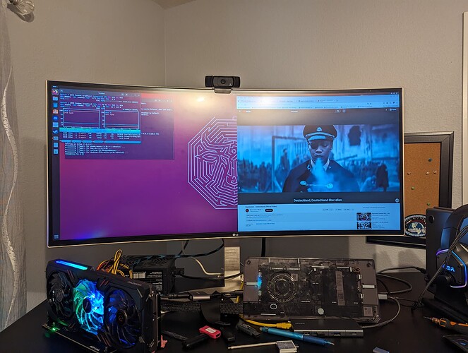

I am attempting to add an egpu to an AMD mainboard through the m.2 port generally reserved for the nvme SSD. The mainboard is in a cooler master case and did not come from a laptop. I have a Samsung 990 pro with both ubuntu and Windows partitions. What I eventually want is for the computer to always boot from the exteranl SSD(plugged into top right usb4.0 port) once it has been moved into an external case.
For background I installed windows first, created a free partition then installed Ubuntu (all with the SSD in the reserved spot). Things operated normally with the grub launcher coming on at startup to select which operating system I wanted to use. I then moved the SSD to an external enclosure (GPU adapter is not yet here so nvme slot was left empty) and attempt to start the PC. I have had no luck getting anything to boot. sometime boot magager will see the ssd and both operating systems but cannot load either, other times is only see 1 of the two, and sometimes it does not see the ssd at all. Does anyone have experience doing something like this?

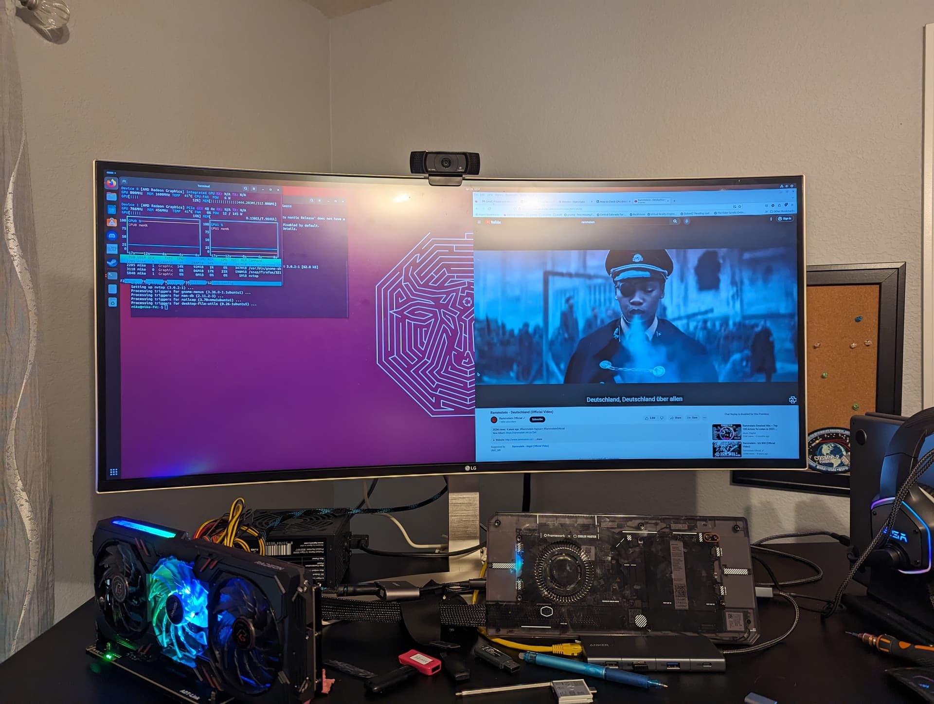

I never managed to get windows to work however i ended up completely deleting everything on my ssd (used disks on a live ubuntu drive to do this) and installing ubuntu 23.10.1 to the ssd. i then moved the drive to an external case. the computer (without changing any bios or boot settings) sees the drive an boots is by default in under 30 seconds to ubuntu. the original reason for doing this was to incorperate an egpu through the m.2 slot. this also works now.
thanks for all that helped
