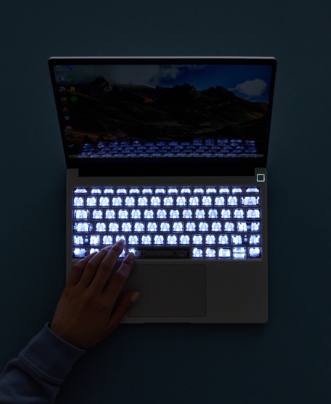

  • The key feels normal when pressed, but the backlight only works on one side of the spacebar (the other side is dark)

That’s the way it’s supposed to be (there is only one LED underneath the symbol for the spacebar, see Marketplace photo of the illuminated clear keyboard).
