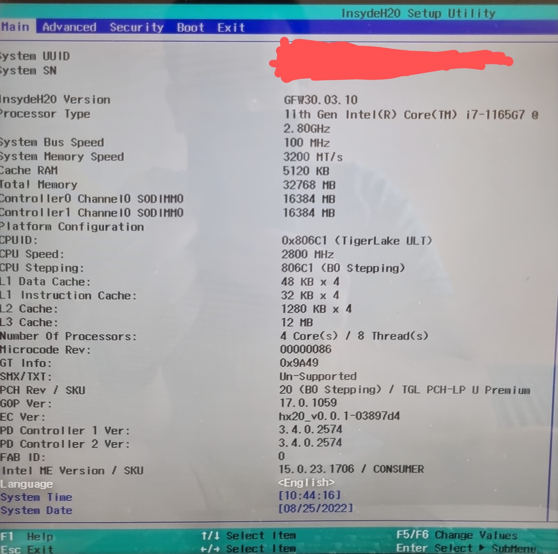

I have a Framework 11th gen laptop. There was a bios update available so like previous updates I typed the command ‘sudo fwupdmgr update’.
It prompted to download and install the new bios update. I confirmed it and rebooted like asked.
Now I am stuck in a boot loop. When the laptop starts it starts my ArchLinux install that then automatically boots into my bios. I then exit the bios and start my ArchLinux install that then boots into my bios. Etc… Etc…
I can boot from a USB stick and reinstall ArchLinux but prefer a way to preserve my current install. Is there a fwup file I can delete so my ArchLinux OS starts again without it booting into the bios?

The system loads my ArchLinux install, since the install is LUKS encrypted it asks me for my passphrase. The moment it unlocks it goes to the bios, like fwupdmgr is waiting for a action to finish.
I have tried F3 while booting and found 2 EFI entries, fwupdx64.efi and grubx64.efi.
fwupdx64.efi brings up a terminal stating that there is no updates to process and then reboots.
grubx64.efi loads my ArchLinux install, I unlock it and then it reboots to bios.
I can boot from a USB stick and see that my data on the SSD is there.
