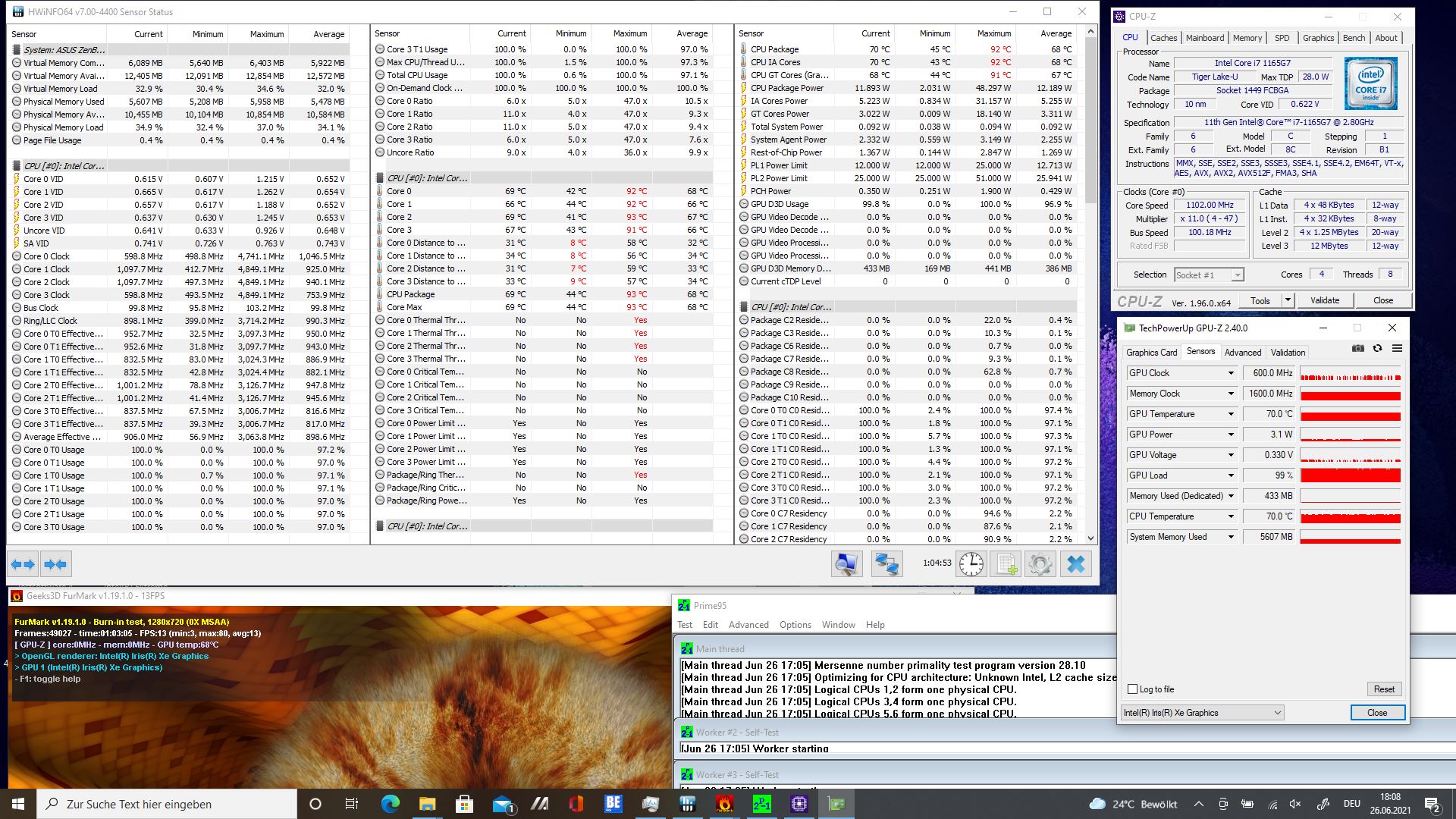

There’s not much room for performance improvement in these laptops. Framework’s cooling implementation allows for the CPU to sustain 28W at ~80C which is already very good. Keep in mind that the majority of laptops in this weight class are throttled to 15W or lower.
I see that many here are worried about the positioning of the fan outlets. However I fail to see the issue–they’re not blocked in any screen position. TBF it’s visually obscured in the closed position but it’s definitely not blocked. The air is leaving–just put your hand near it and you’ll feel it.
AFAIK there’s no inherent design flaw in the cooling system of this laptop, where a simple mod will get you any significant performance boost. If you feel that the chassis is getting too hot, then you should limit the CPU or use a cooling pad (which BTW only improves surface temps, not performance). If you’re unsatisfied with the performance of Tiger Lake-U at 50W boost/28W sustain then the only way to get your performance needs is to switch laptops.
