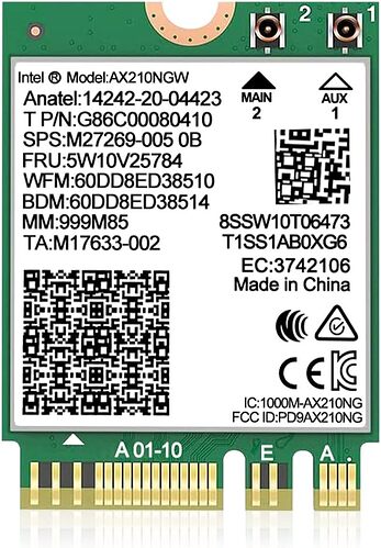

I’ve got a Framework 16 running Fedora Linux 42. It came with the MediaTek RZ616 Wi-Fi card, and I was having major issues with it. Pings were usually fine, but going to any site for the first time would sit for 3-4 seconds before loading the page. I tried a lot of things to diagnose it - originally I thought it was either IPv6 weirdness or DNS issues. There were similar issues with speedtests too though - The speed would start slow, then speed up, then sit still (0 bytes/sec) for 3-4 seconds at a time. Speeds fluctuated the whole time.
I swapped the Wi-Fi card for an Intel AX210, and all the issues went away. Pages load as expected, and I have no trouble consistently reaching ~765Mbps in internet speed tests over wifi.

I did the same thing with my Framework Laptop 16 after getting tired of the slow startups, hangups, bluetooth dropouts, etc. Changed to the Intel AX210 and it was a night and day difference.
I had waited until I was going to order some more cards and another accessory and added the AX210 to my next order. This card from Intel It has been around long enough there are lots of them in the wild now.

I saw a lot of posts saying this, just recently upgraded my FW13 on 7840U to the AX210… However, the wifi speeds are worse than that god awful mediatek chip. I was getting reasonable speeds beside my router with it, now, even 2 feet from my router on 5ghz I’m getting 150 down instead of 500.
What could be causing this? Fedora is fully up to date and kernel has appropriate drivers?
I’d double-check that the antennas are securely attached. When I was replacing the Wi-Fi card on mine, I thought the antennae were properly attached, only for one of them to pop off when I started to put everything back together.
No luck unfortunately, very stable 160 down even after reseating it all. Thank you so much for the suggestion though, I appreciate it!

And swapping back to the mediatek gives you the “reasonable” speeds again? If not you may have damaged your antenna connectors.
The ax210 in mine does like 1.4Gbit over 5Ghz with the ap in the same room, 150mbit would even be slow on 20Mhz wide 2.4Ghz (wifi6)
For what it’s worth, the speeds in my original post (764 down / 658 up) are on wifi 6: 80Mhz-wide 5GHz.
Around 800mbit on 80mhz checks out.
