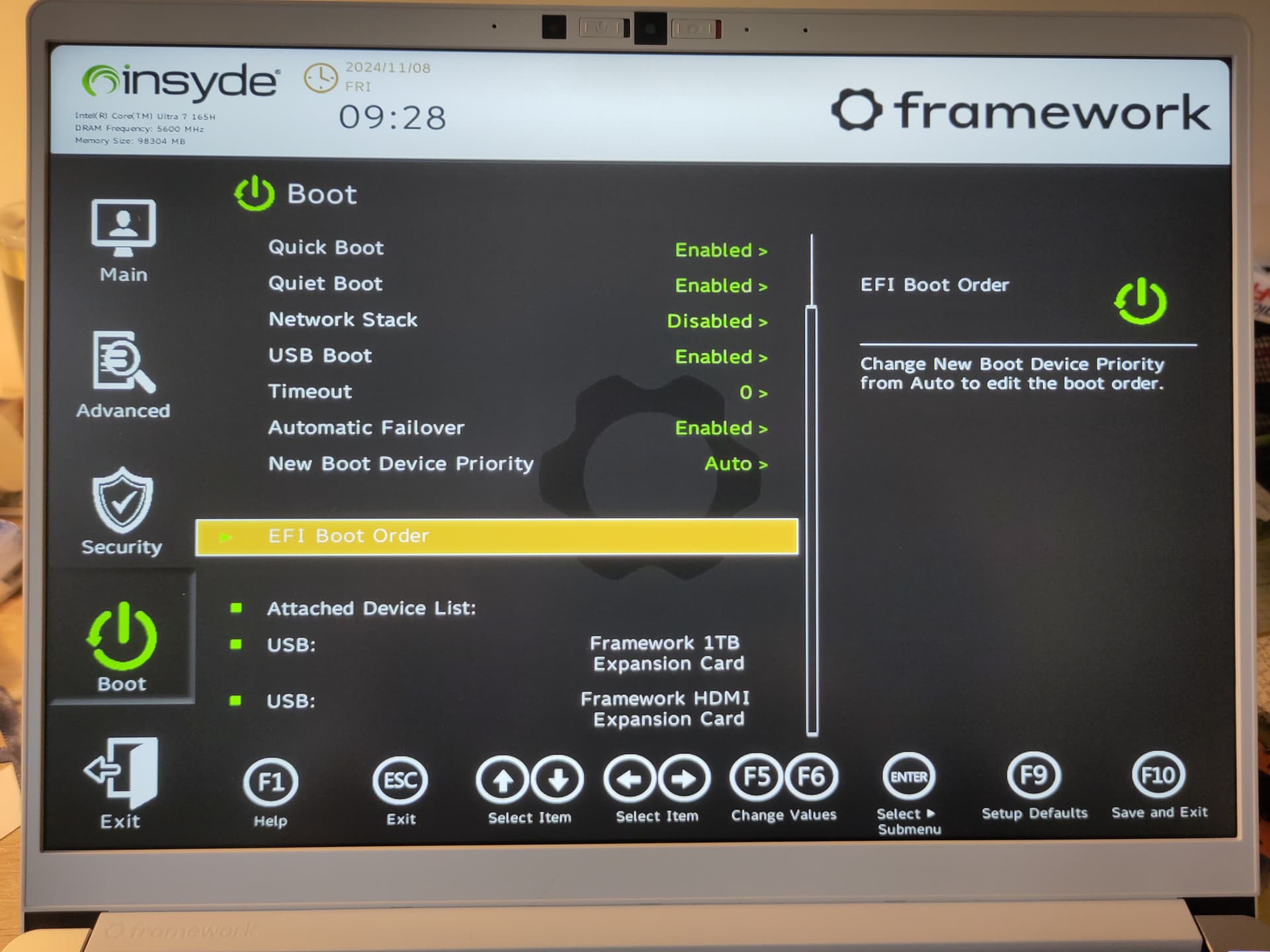

I do not see it in the BIOS. But it could be because I am not looking at the proper place. I’ll send pictures from my phone
Here are picture from the bios
And another one (I’m limited to 2 pics / message)
Something is wrong with the ssd. Did you insert it all the way to the slot?
Or if you can try with an other pc/laptop does it work there.
The drive can be dead, or also the motherboard might have a broken ssd slot.
You should contact fw support anyway
