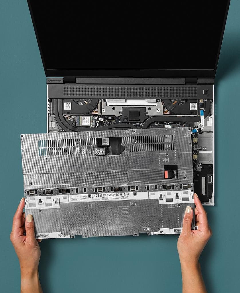

This is the midplate underneath the keyboard:
I don’t know exactly how permeable the keyboard module itself is, but I’d mostly worry about liquid getting into those slots at the top. One is for the expansion bay interposer, and is probably covered by a rubber gasket and the interposer while in use, but the others open to the mainboard. You could always buy just a replacement mainboard if necessary, though!
As long as the keyboard directs the liquid off the “spacebar side”, the midplate doesn’t seem to contain any major gaps on the bottom half that would let liquid through. From experience, though, the key switches themselves don’t much like liquid poured into them.
