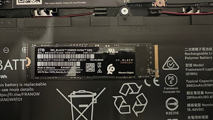

Hi there,
I spilled tea over my laptop and I dont know where to start with the repair.
I dried everything for days, 1st it turned on but couldn’t find the drive and stopped at the bios, I let it rest for a few more days then tried again, same only boots into BIOS. Opened it up to see if I can see some spillmarks on the NVMe but when opened it it did smell a bit burned I think… when I closed it up again now it doesnt turn on at all.
my question:
how do I know what I should order? Should I order every part and return the ones I dont need? Could be the fan or the motherboard, or the ram or the NVMe. NVMe is easiest to test as I have some spare ones but it doenst turn on at the moment so cant imageine thats the problem.
thank you!

A picture of the motherboard would also help - usually you see more on a picture then when looking on it (marvels of phone cameras).
amazing thanks @Jorg_Mertin attached a few pictures.
Did any tea go through the keyboard etc.? Because it looks quite clean to me.
yes 100% I found drops of tea around the fan area and underneath the fan dripping through the grill on the underside
If it went through the bottom to the fan etc. it can have shorted some parts.
But as with all troubleshooting, you need to try and error until you find what does not work.
Remove everything, then try to boot, at least to go into the BIOS. And continue from there.
If it does not power up anymore, then something is already fatally broken. it will be up to you to decide from here on.
