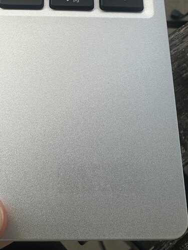

Input cover kit quality: In early August 2025, I installed a new input cover kit with a different keyboard layout. Out of the box, it already had some cosmetic defects (small marks/smudges that look like production artifacts). I tried cleaning them with alcohol, but they don’t come off.

I would open a ticket with Support regarding the marks on the input cover, as that looks like something that would be replaced under warranty. I’d note the bezel issue as well. Although that may not be covered, it would be good for them to note it if they are tracking those things (and hopefully they are).
The same marks appeared on the input cover of my laptop 13 after about a year of use. I managed to clean them away with lens cleaner that contains some alcohol. My laptop does not have any cracks and feels solid after a lot of use.
