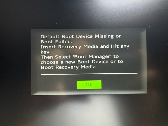

My FW16 (AMD Ryzen™ 7040 Series) can't boot from my usb drive
I just received the FW laptop and tried to boot fedora 42 from the usb drive after turning off secure booting and enabling booting from usb options. Unfortunately, whenever I selected my bootable usb drive (whenever it’s finally detected by the computer), it would say, “Fedora boot failed”. I don’t know what to do. Please help.
Edit:
I formatted a usb into exfat and then into a fedora boot using disk utility on my Mac. Whether it’s at start up or in boot manager, it gives me a boot failure message.

Share errors with us. Preferably clear screenshots.
I’ve inputted the images in the original post.

It’s a SanDisk 64GB Thumbstick. I used balenaEtcher just like the guide said. I tried both suggested ports, but I still get the error message. Also, I tried selecting every single file on the thumbdrive, but error message is the same: \some\path\file boot failed.
I’m so dumb. I accidentally downloaded the wrong fedora workstation 42 file; it was for ARM® aarch64 systems, not the AMD system. I was so excited about my new laptop that I neglected to verify that I was installing the correct version of Fedora in the first place. If you’re reading this, please don’t make the same dumb mistake that I made. I thank everyone who tried to help me.
