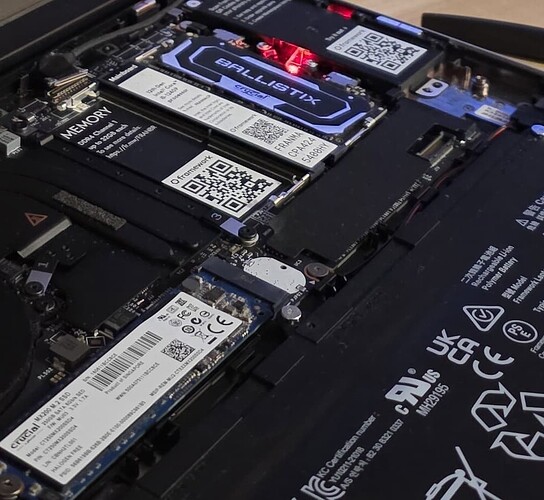

Like many of you, I snagged a mystery box mainboard and I’m having a slight issue. Luckily mine boots and works since I had a Framework chassis laying around. The issue is that the CMOS battery holder is simply not there. Does anyone know if it’s possible to source a replacement? It looks like the plus and minus terminals are still there so that’s a plus. Technically speaking I dont HAVE to have the CMOS, but I’d like to get the part if I can find one.

I looked at that RTC battery previously, but I dont see an obvious plug for it on my mainboard. In the pictures, it appears to be used for a 16” mainboard.
I don’t have a FW13, but from your photo, it should be possible to solder the wires to the contacts there (middle of photo):
That battery is for the amd motherboards I think. Not sure why Framework is not selling the correct ones for any other boards. But you can probably just cut off that connector and solder the wires to the board where the battery holder would normally go.
Im an idiot. I went to their GitHub page but didnt scroll down. They literally list the part number they use for exactly the OEM part. While yes, I agree that I could probably get away with cutting and soldering that battery they sell, I’d rather just slap the correct part in place. I appreciate the community involvement though. Framework-Laptop-13/Mainboard at main · FrameworkComputer/Framework-Laptop-13 · GitHub
