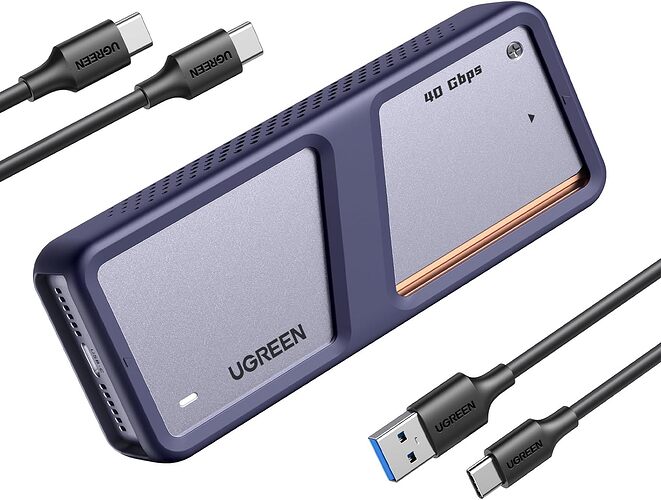

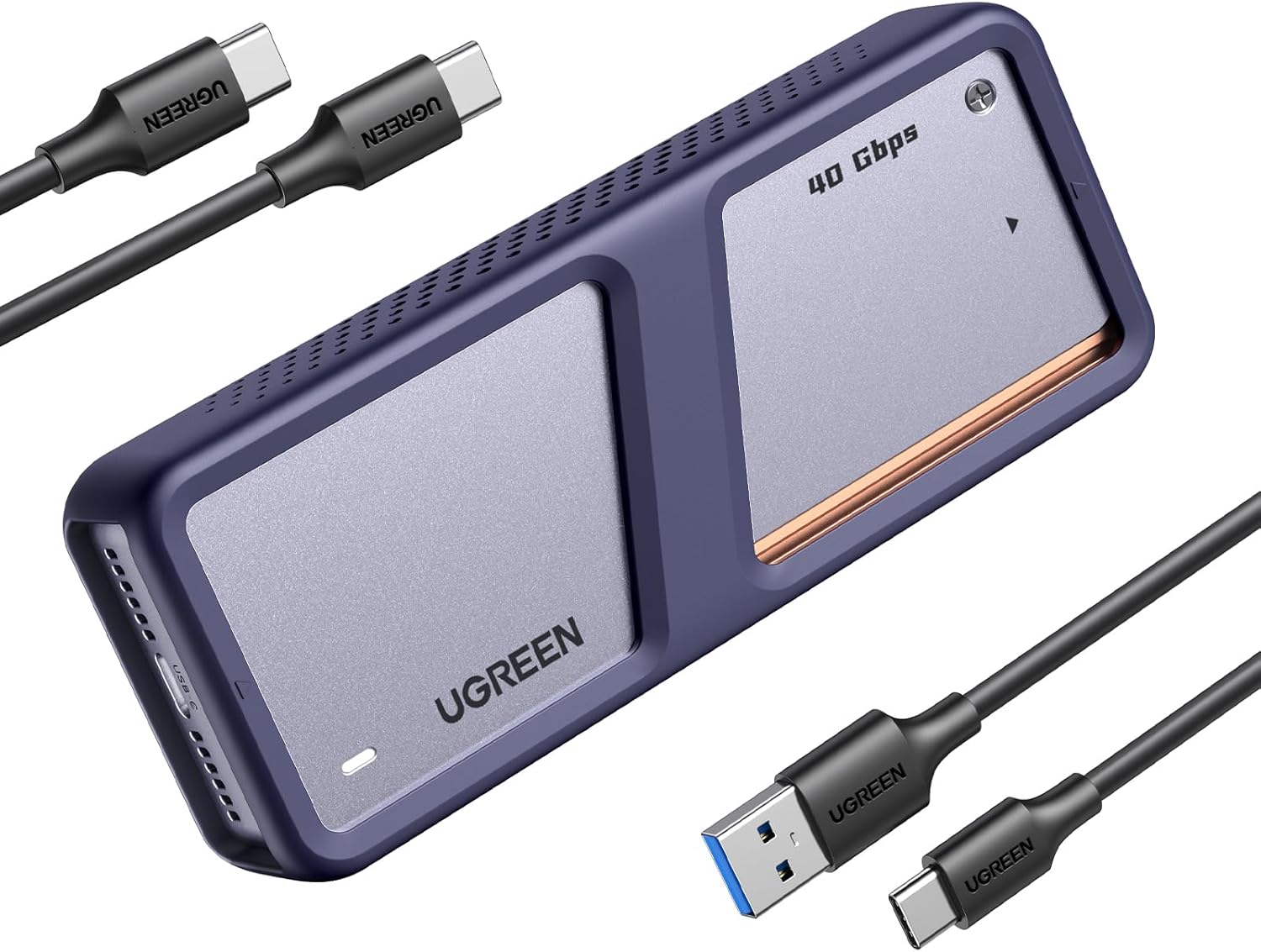

I have a thunderbolt enclosure and E-key adapter.
When I tried the BE200 in it, the laptop did not crash, but at the same time the PCIe device for the BE200 never appeared. It was just the same as not plugging in the BE200 at all.
I am guessing that maybe the thunderbolt enclosure did the failing bit, and isolated the problem from the laptop.
When instead, I plugged in a different (not the BE200) Wifi card, it worked OK via the enclosure.
It was this enclosure:
Mine was an intel based tb adabter, it is possible whatever the be200 does on pcie allready offends the asmedia chipset in the enclosure so it doesn’t get to the point of crashing the system XD.
That is what I suspected also. That is why I posted details of the exact TB enclosure I was using.
