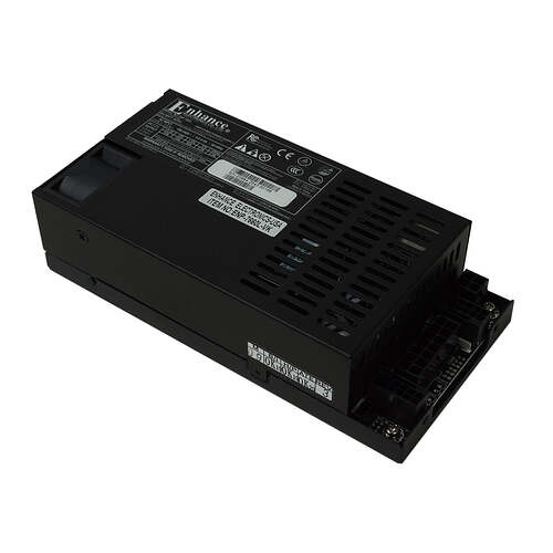

Side note, but I’d be interested to know if there’s a different PSU that fits very well in the case. Not just form factor but cable lengths and so on. I found a couple which supposedly has customized cables to make them shorter (and one modular). But since this is fairly niche I’d really like to know that something works well before ordering myself. Anyone tried these or something similar?
