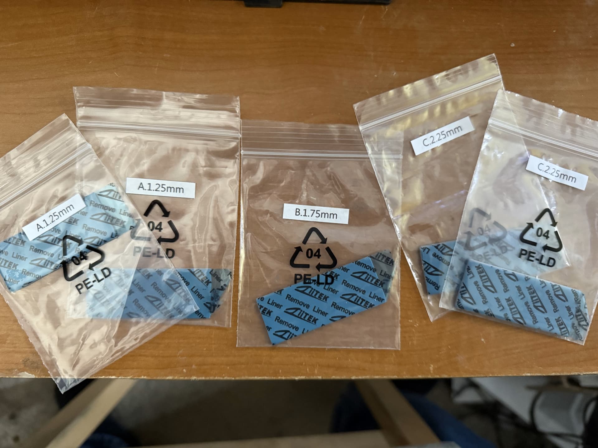

I have my adapter in hand, but there is a discrepancy between the Thermal pads that I received and what the Guide states.
Guide says to apply “2.25mm thick Thermal Pad (Bag B)” to the back of the M.2 module and to use either “1.75mm thick thermal pad (Bag C)” or “1.25mm thick thermal pad (Bag A)” to the SSD depending on thickness (single/double side).
However that does not match what was shipped. I have thermal pads labeled as follows
2x “A.1.25mm”
1x “B.1.75mm”
2x “C.2.25mm”

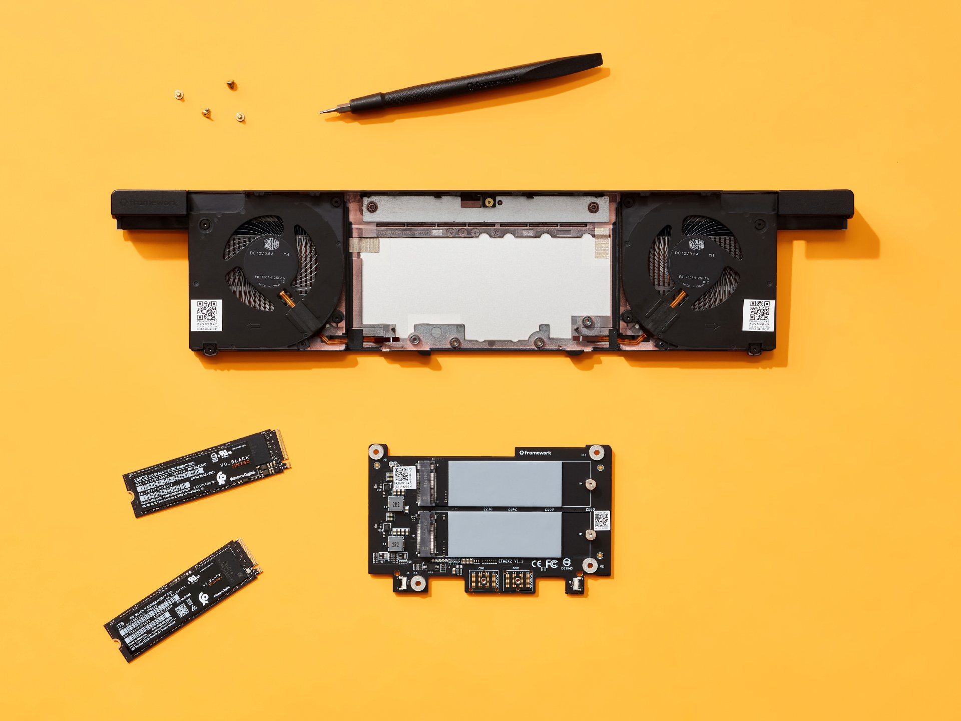

It’s not clear from the pictures. How are the nvme ssds cooled? Is there airflow over the ssds? Is there any room for ssd heat sinks?
There are thermal pads connecting them to the bottom of the case.
