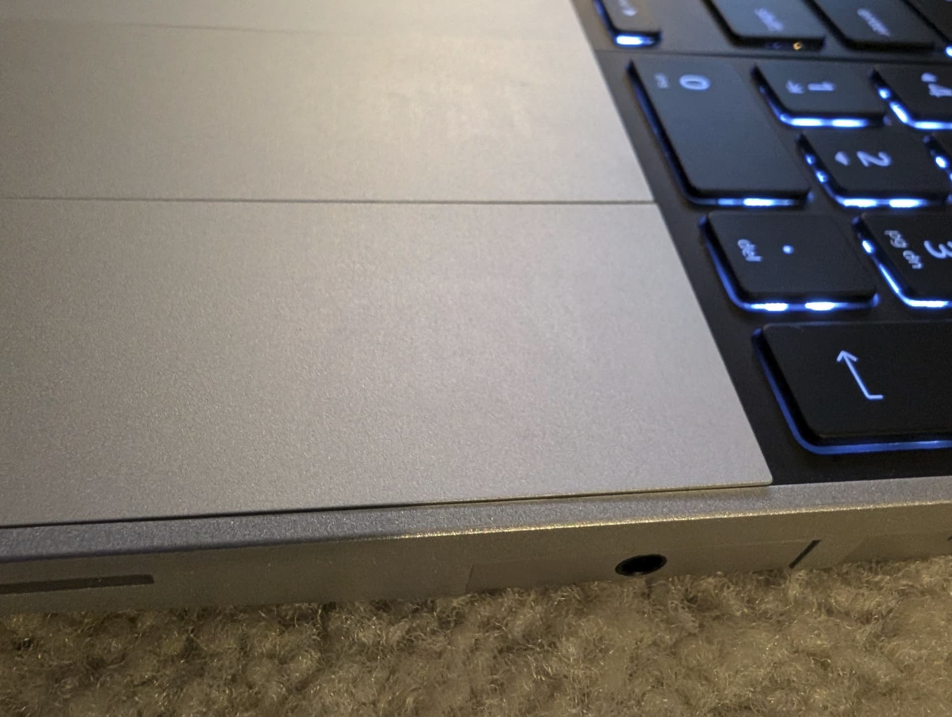

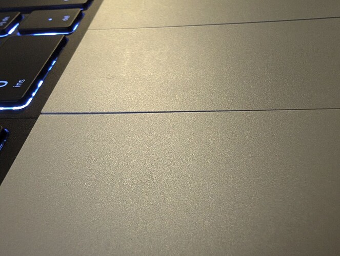

The spacers on my laptop consistently rise up slightly above the trackpad and frame of the laptop, any idea what’s causing this? The baseplate and numpad seem flat. If I push down on the top of the spacer I can line it up with the rest of the base, but it goes back up.
I saw this after I reinstalled my midplate after some upgrades. I found out that I hadn’t properly latched the spacers into the channels on the midplate before sliding them into place. I backed them off a bit and pressed down slightly on the area where they engage before sliding them and got them flush.
