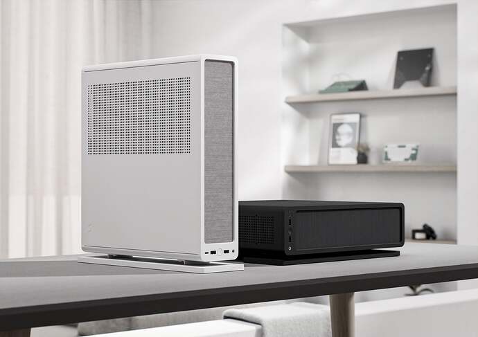

Case: Fractal Design Ridge in white or black = ~136 EUR
Note this case might look small, but I’ve seen people slapping a Sapphire Nitro+ 9070XT in it which, from my own experience, is a absolute beast of a card given size and weight.

However I would still check for mainboard + fan size before buying this case, as they are quite massive
That’s why I mentioned the Sapphire Nitro+, it gets a little bit crowded due to the sheer size of this card, but it fits and takes all three external slots. Mind you, together with a enthousiast UATX AMD gaming mainboard.
So this Framework mainboard without a external discrete GPU should also fit I suppose.

the Fractal Design Ridge looks beautiful but the specs list it as only having 70mm clearance for the CPU cooler, where Frame.Work recommends a minimum of 92mm.
I’m not sure plugging in an AMD RX 9070XT would give much benefit considering that the PCIE slot is limited to x4, and even then I’d need an adapter to go from x4 to x16.
