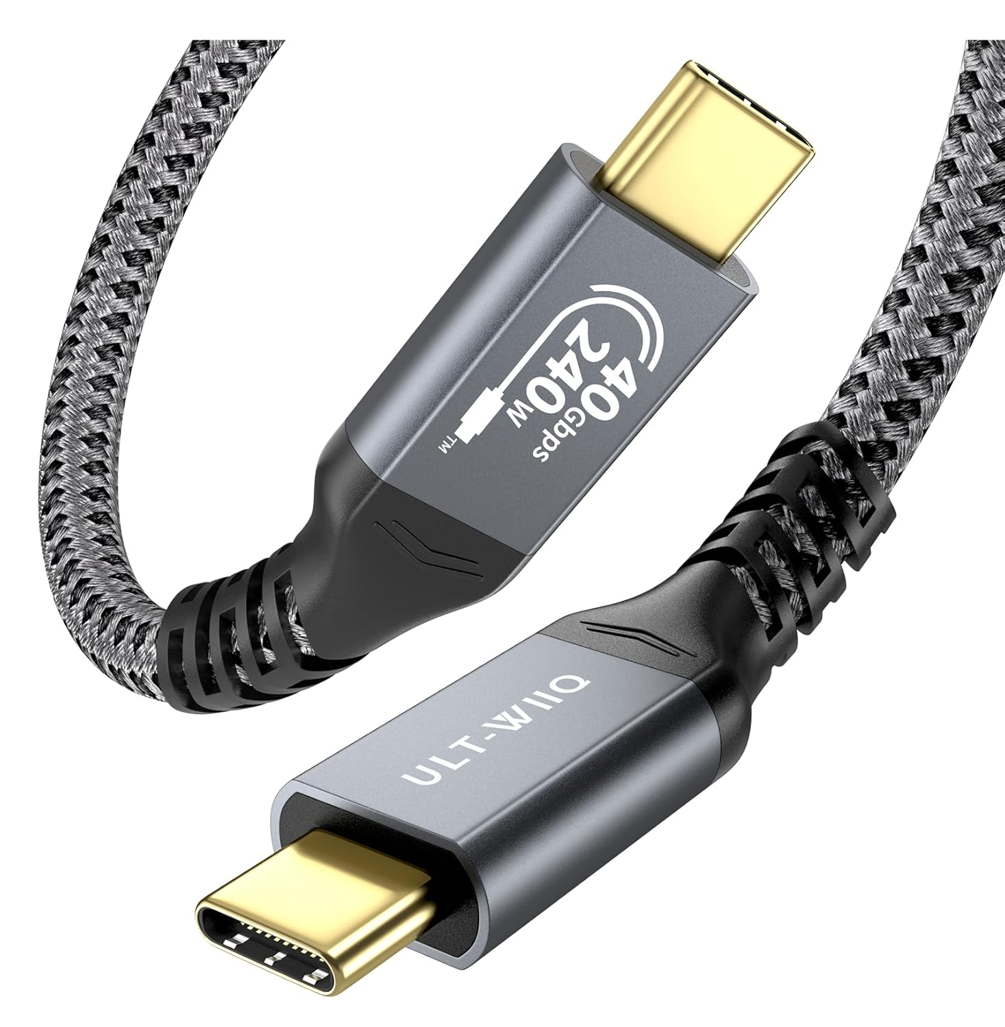

I have a Dell notebook with two Thunderbolt-capable USB-C ports and my Framework. Windows 11 runs on the Dell and ArchLinux with the latest update on my new framework. I would like to use the network functions of Thunderbolt. This allows you to set up a very fast P2P network. I bought this cable to connect the two notebooks:
If I use the Thunderbolt port on the back right of the Framework to connect the two devices, I can’t establish a network connection. I only see the following messages in the log as a loop:

It seems to be a problem with the cable length. I have just used a longer cable and it works on both sides. But there doesn’t seem to be any problems with the short cable when using an SSD. I have also rotated the cable several times to rule out missing pin assignments. It also does not explain why the short cable works on the left side and not on the other side.

If the problem occurs only with one specific USB cable and it works with another cable, I would say the cable is likely the issue, not the laptop.
The cable you linked above seems to be certified for USB 4 but not directly for Thunderbolt, so it’s not impossible that it doesn’t work as expected.
(USB 4 cables should be compatible with Thunderbolt 3 but they might not work with Thunderbolt 4).
Also the cable you linked above doesn’t seem to be officially certified with thunderbolt (missing thunderbolt logo on the cable) so it’s not impossible that it’s not working as intended.
Here is a cable that seems to be certified for thunderbolt 4 on amazon.de.
I can fully understand your thoughts and that was my first thought too. And if the cable always had the problem, I would immediately sign it with blood. I also have a working cable, but I want to understand it… at a technical level.
