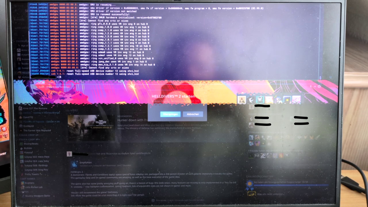

Does it by any chance look kinda like this?
The thing in the glitch with the framework logo is my desktop background
well kind of, but not in that color thought.
It has a temporary tear in display for maybe 5 ms and goes away and can come back again and happens more often on scrolling on websites.
Mine does not thought do the desktop appearing, instead mine is like it tears the display temporarily real quick.
