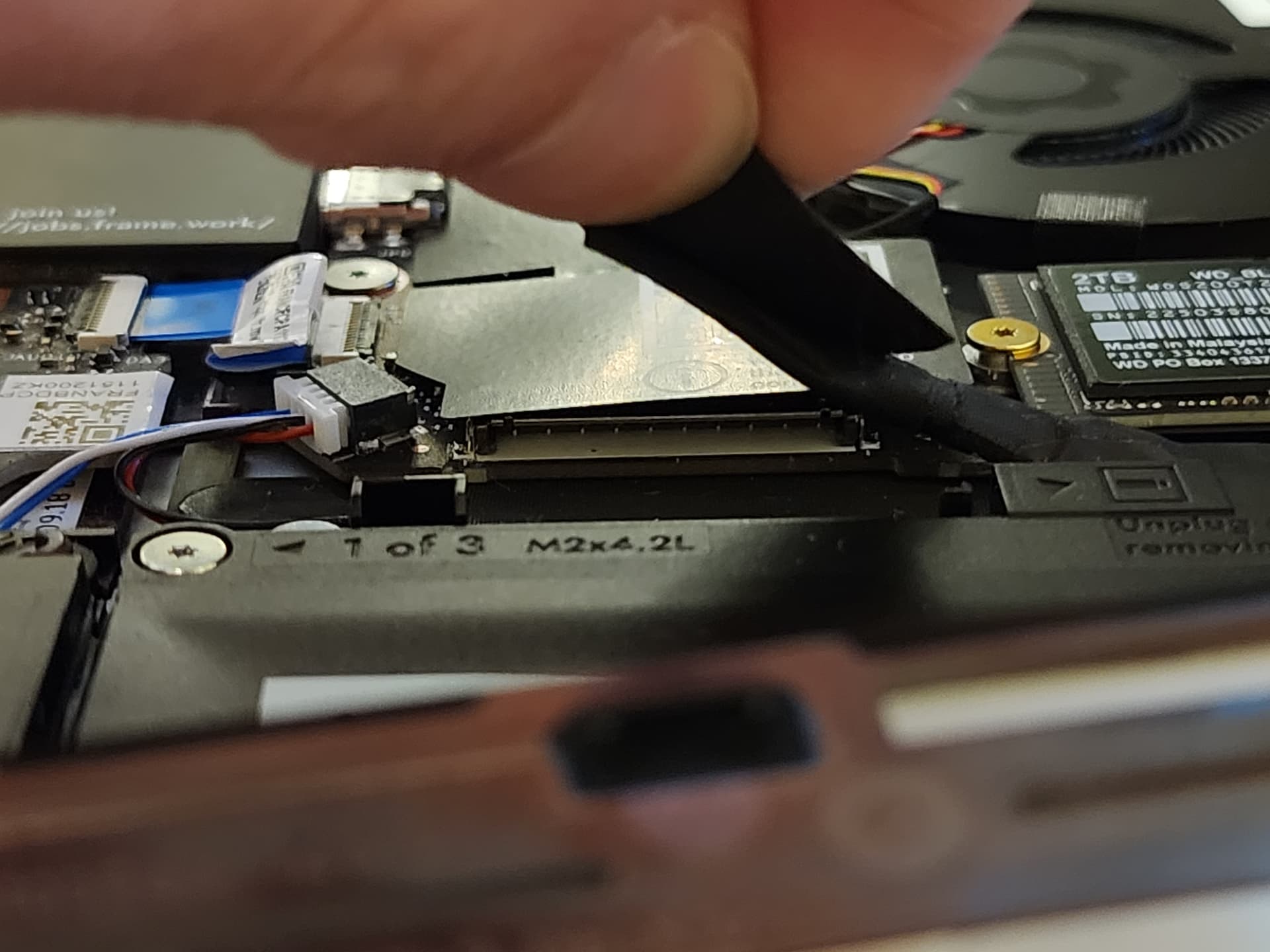

The reason why I say they are faulty is mainly because I know it is not a software issue nor a damage issue since during the installation of the parts I made sure not to damage anything. There was no physical damage on the product on arrival nor is there right now, and I have done all the proper software installations that are necessary to get started. ( I have had experience in building about 4 desktops at this point in time so I am modestly confident about my abilities). I have been to the utmost of ability careful with the battery connection, and here is a pic of the port in great condition.
Since I needed it quick and there are no options to buy a laptop in DIY or prebuilt currently, I bought all the parts of the laptop individually. I would like to return the parts that I think are at fault right now, but that means I ate the shipping costs that I paid for in the first place and I am really tight on budget.
