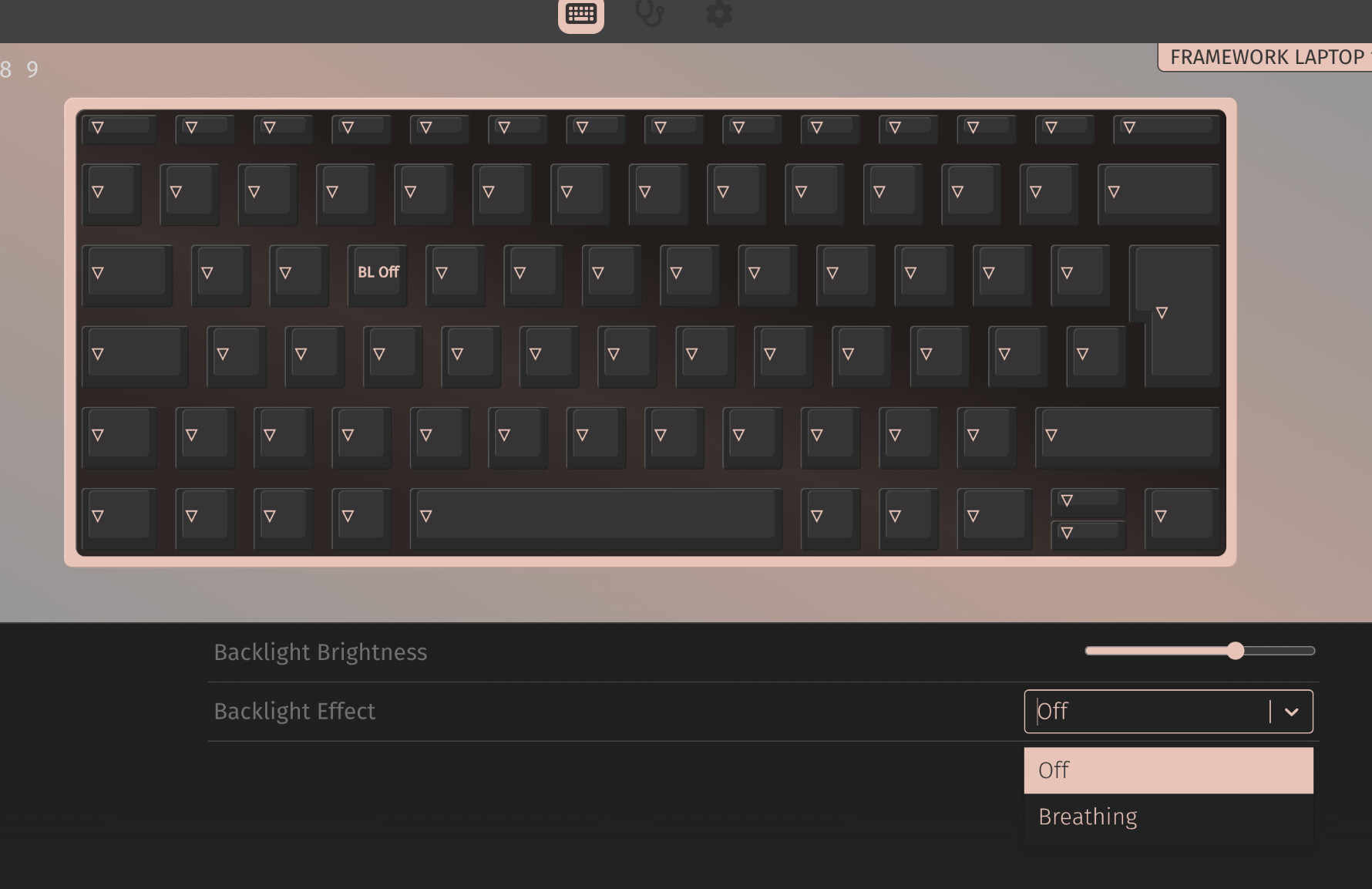

Which keyboard do you have?
Can you check what it’s set to in the lighting tab in Via (keyboard.frame.work)?

Thanks MJ1, your first suggestion re: udev worked. I just accessed that website and the effect was set to “spiral” something. I’ve turned effects off, which I imagine will fix this issue. Is that your assessment as well?

My keyboard was set to “breathing”. No idea why…
For the keyboards, Fn+C toggles Backlight Breathing on/off.
For the numpad, Numlock off + + (the plus symbol) toggles Backlight Breathing on/off.
It’s missing from Framework’s hotkey list, but it’s present in the current firmware’s keymap.
