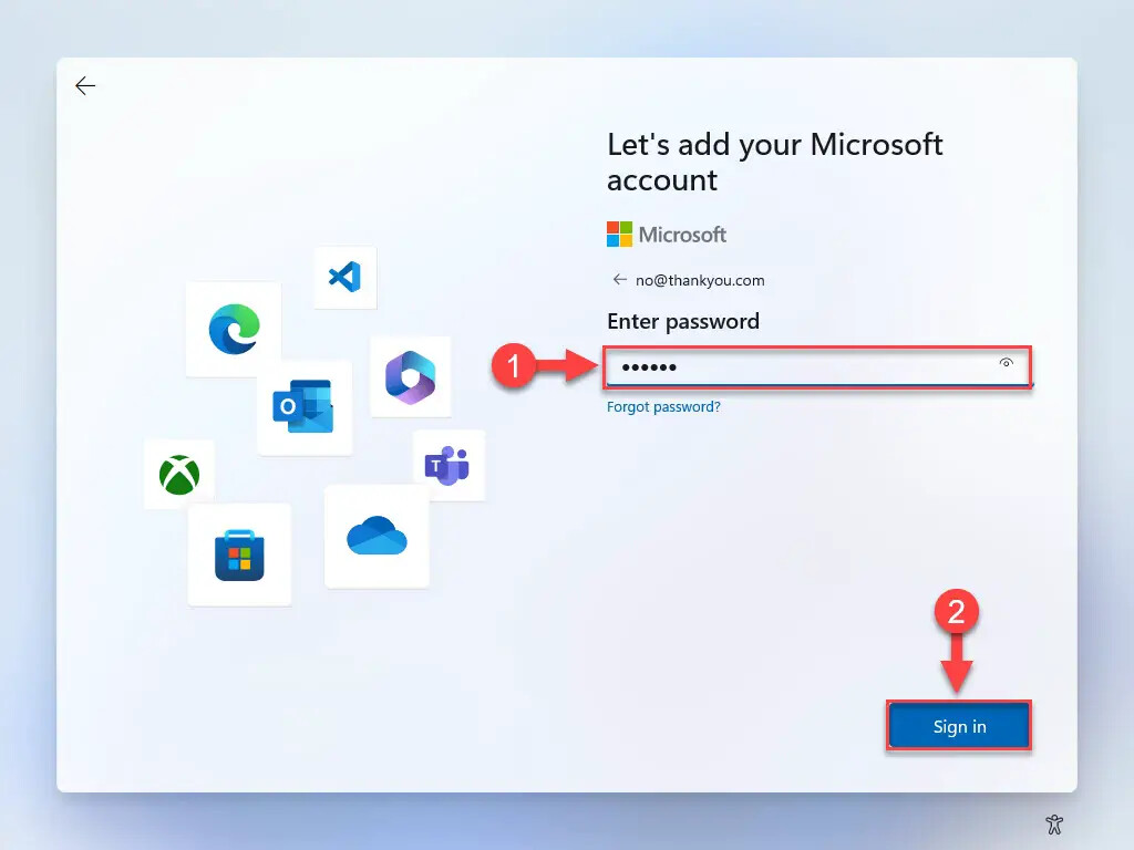

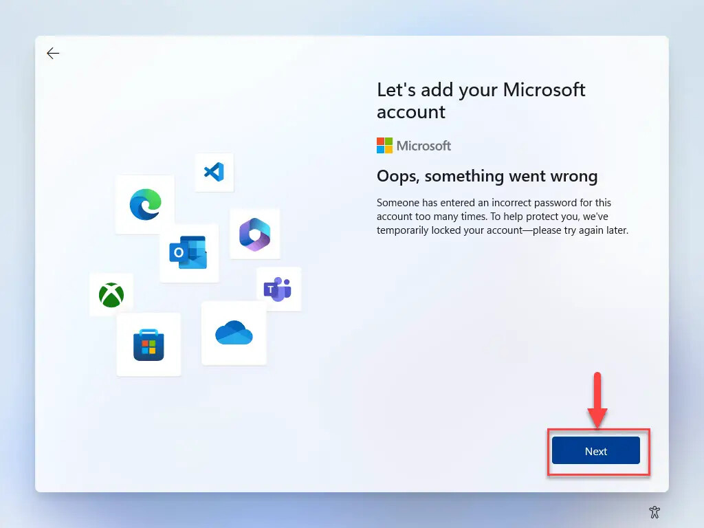

I tried installing Pro on a VM and the “I don’t have internet” option was missing… I found a guide online that described trying to sign into a disabled account before continuing:
This needs to be done after running that OOBE\BYPASSNRO command

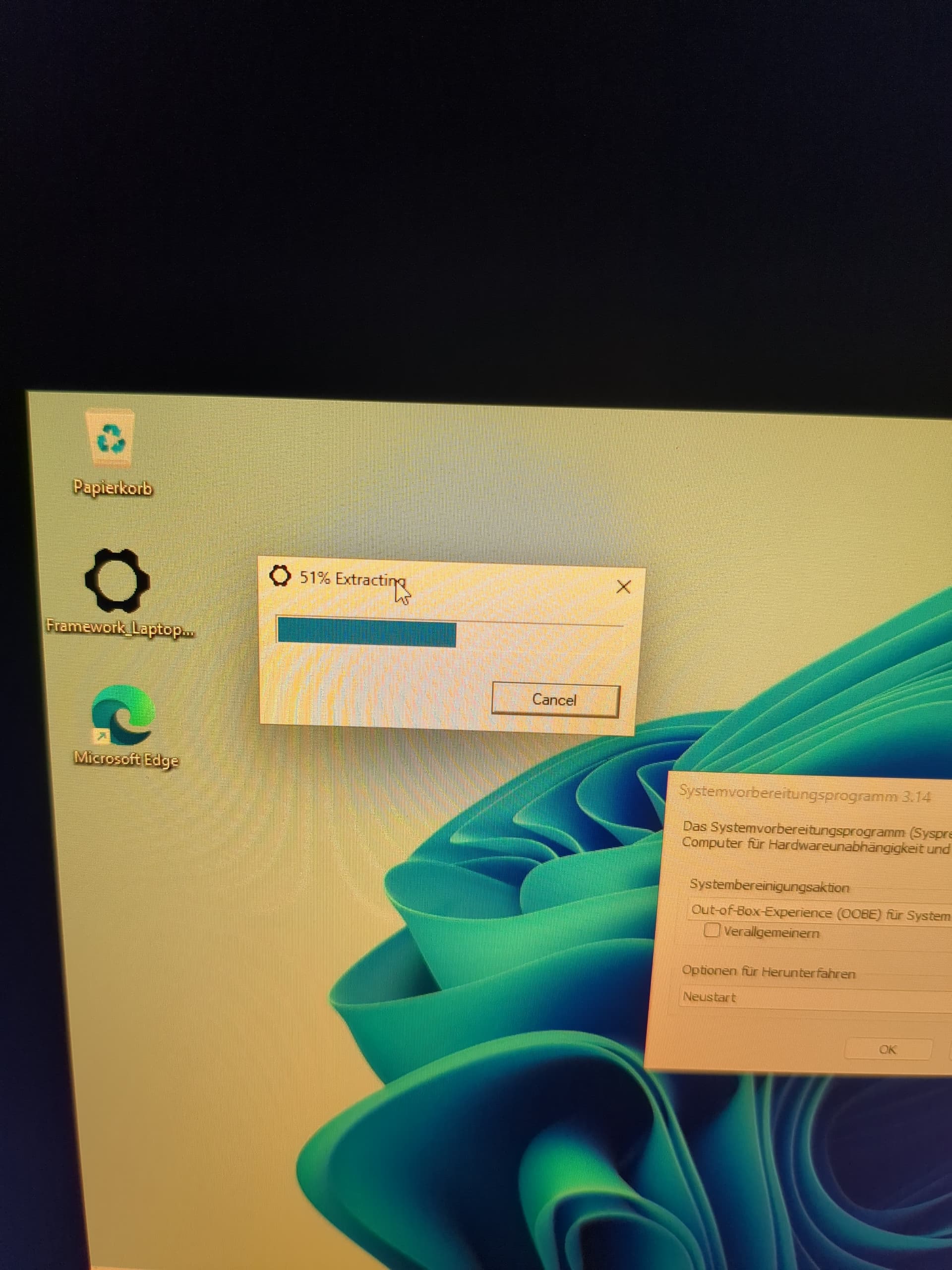

Just to update you, I found the drivers for it and it allowed me to install it now… I kept searching for RZ616, but I found them after I searched for the Mediatek mt7921
It allowed me to at least get further than before
*the dark-patterns deployed have indeed been more advanced than even shift-f4 or f10, I had to hit ctr+shift+fn and f3 to enter windows as admin and I am being shown this page:
Something something in German about OOBE !!
Just tried installing the FW exe file with drivers, but it said I don’t have a Ryzen amd, eventhough I do have it…
Anyways, now I will just install rufus on it and create another win11 iso the correct way using this incomplete installation
