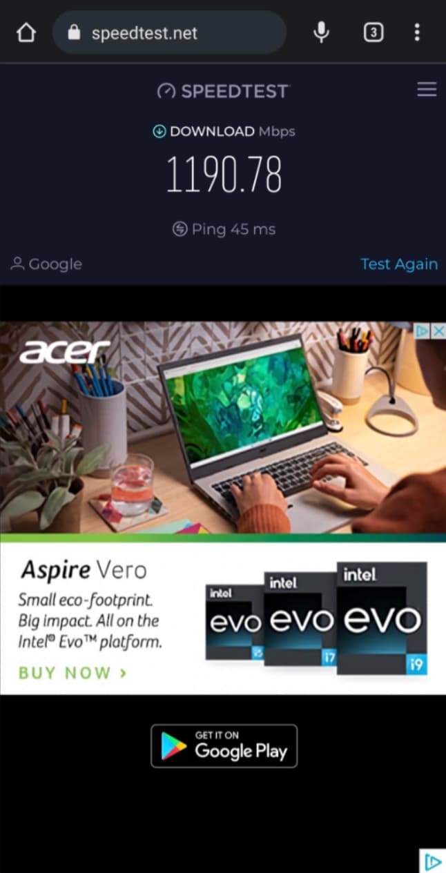

Including a speedtest from my phone (Pixel 7P) to illustrate the speed to the clients.
From Chrome browser with mobile data turned off.
The only other client that experiences sub-gigabyte speeds on my network is the Playstation 5 and that’s because Sony throttles the connection :confused:
Purpose of this post, if you’re paying for a speeds and you’re not getting close to those speeds on the clients, you have a problem. My problem is the firmware from Intel for linux systems.
