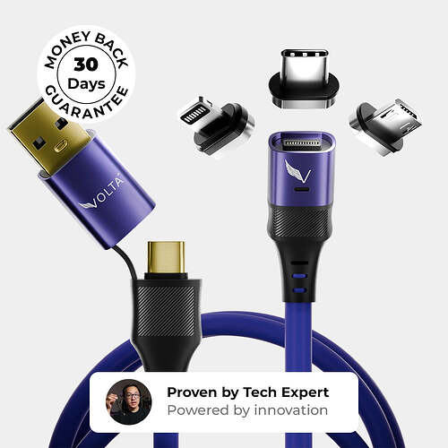

I’ve used these guys in the past…not cheap but good quality, and the Volta Max cables support 240w charging…
There are much cheaper options on Amazon, but I’ve no idea of quality…there are also magnetic tip convertors for an existing 240w USB-C cable…
But how do they handle the issue @James3 pointed out? Dont they have the same issue?
Edit: i guess after looking into their page they “promise” of overload protection and that it should be safe with 240
I’m not sure there is/can be a definitive answer as James has noted that his comments aren’t based on personal experience.
I’ve used the older (lower power) Volta magnetic cables without any issue - they are good quality. I also have several of their chargers and am more than happy with these too. If you are concerned, I’d suggest you contact the Volta support team and ask for their advice?
If there have been cases of fried laptops from the use of magnetic cables, then I would suspect these are from people using any number of the no-brand cables from sources like China…there are numerous examples on Amazon that I would totally avoid!

There are countless reports of magnetic USB cables killing devices or causing the ports to malfunction. No brand is different.
They just don’t.
Volta has not shown even an attempt at protection.
Volta is exactly the same. They just charge you more, for the privilege of killing your expensive hardware.
For a dead device, and Volta ghosting you, look no further than our own forum here:
