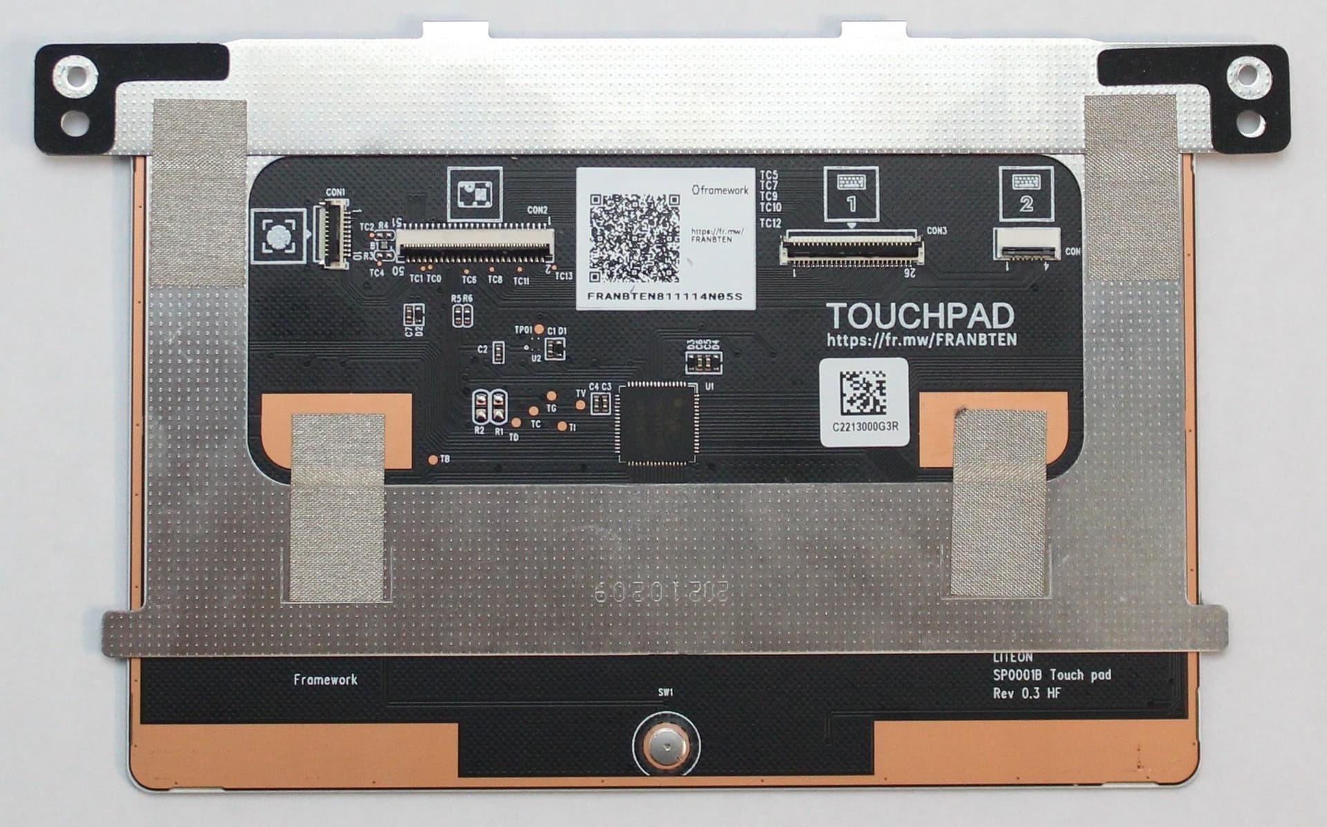

I believe it should be possible for them to add qmk to the keyboard in a way that should be compatible with past Framework mainboards. It should even be an option for a hobbyist to make an add-on board to convert an existing FWL13 keyboard to qmk. Just need a little pcb design skills, or the interest in learning via youtube tutorials.

I mentioned creating an add-on board. USB2.0 hub chip, RP2040, and connectors for the keyboard matrix cable, backlight cable, fingerprint reader cable in, and fingerprint cable out. The fingerprint reader has a USB line that you can use a hub chip to share. Not sure what the z height space is underneath the touchpad PCB, the hope is that there is enough room for a slim add-on PCB to be stuck there. Perhaps an ultrathin kapton/polyimide flex PCB if needed.
That would work, though the fingerprint reader connector is on the other side of the mainboard.
Also you may want to use a more power efficient platform than an rp2040, I recently converted an old thinkpad keyboard into an external one using zmk and an nrf chip which was pretty sweet (plus ultra low power bluetooth XD).
The fingerprint reader cable runs through the touchpad board, same as the keyboard matrix and backlight cable.
Fingerprint connector is the 10 pin one on the left. Keymatix is the 26 pin connector labeled “1”, backlight is the rightmost one labeled “2”.
Oh, I wasn’t planning to do it myself, I have no need. I was just mentioning that it should be possible for anyone interested.
Interesting, one of these days I am going to delete the fingerprint sensor and use the usb for something else, I just need to find something else to use it for XD. Being able to grabb it here may be more convenient.
