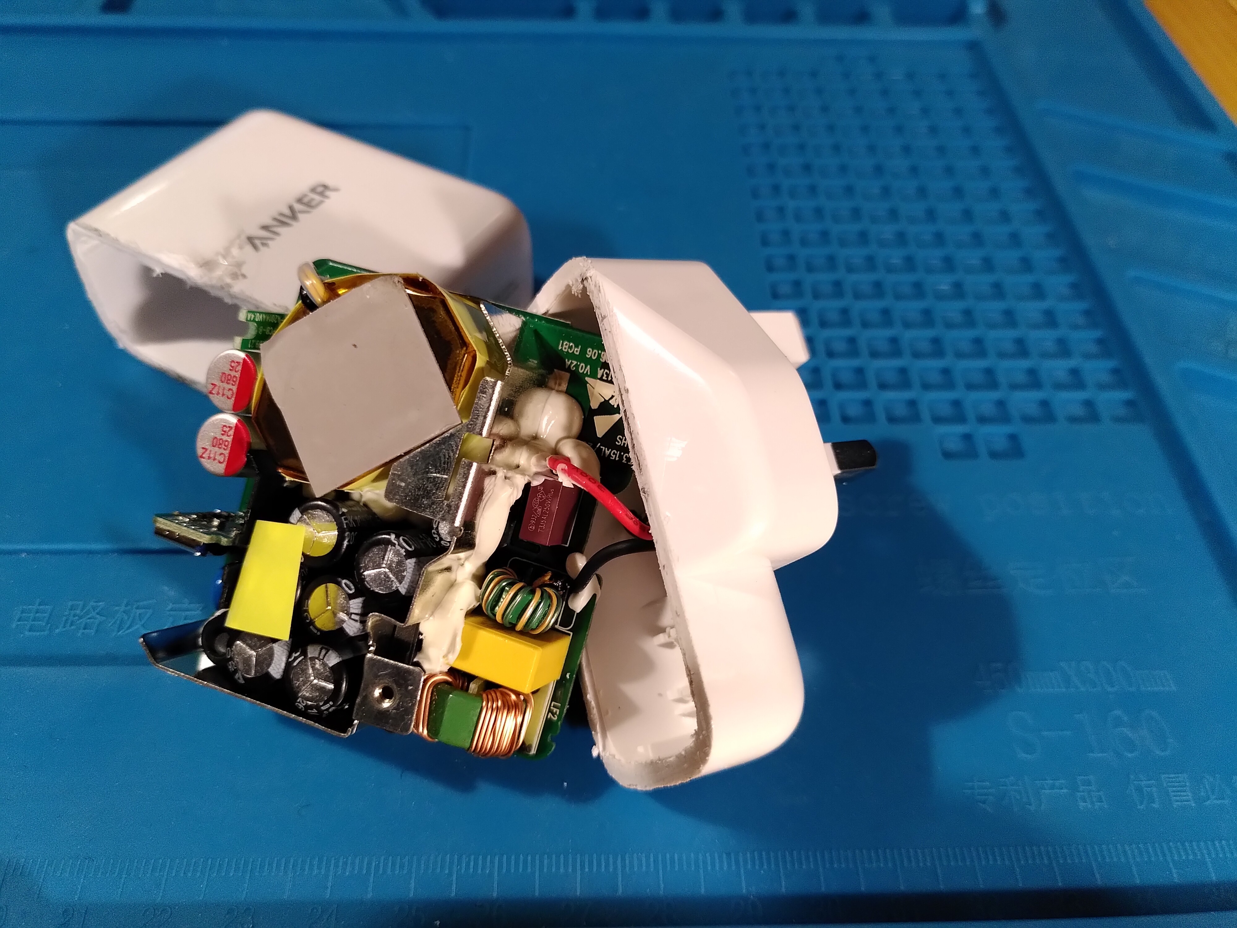

Don’t recommend the Anker PowerPort Atom 3 60W, Didn’t even use it on a laptop, died after a few weeks of charging the battery pack it came with.
10 seconds out of warranty naturally.
0/10 longevity
0/10 Repairability
(moulded closed enclosure and packed with silicon goop)
There is a reason you are not supposed to repair any power supplies. Hundreds of volts awaits (for weeks)!
Although there are designs that don’t have a completely molded-shut enclosure. But they are usually designed so they are never supposed to be opened.
I never trust those “wall-wart” style ones as they need to be as small as possible to be a “wall wart” which means packing components very tightly together. Even with GaN heat buildup can be a problem (especially with 30W+ ones) which reduce the lifetime of components.
I will assume that when opened the inside smell like burnt plastic.
