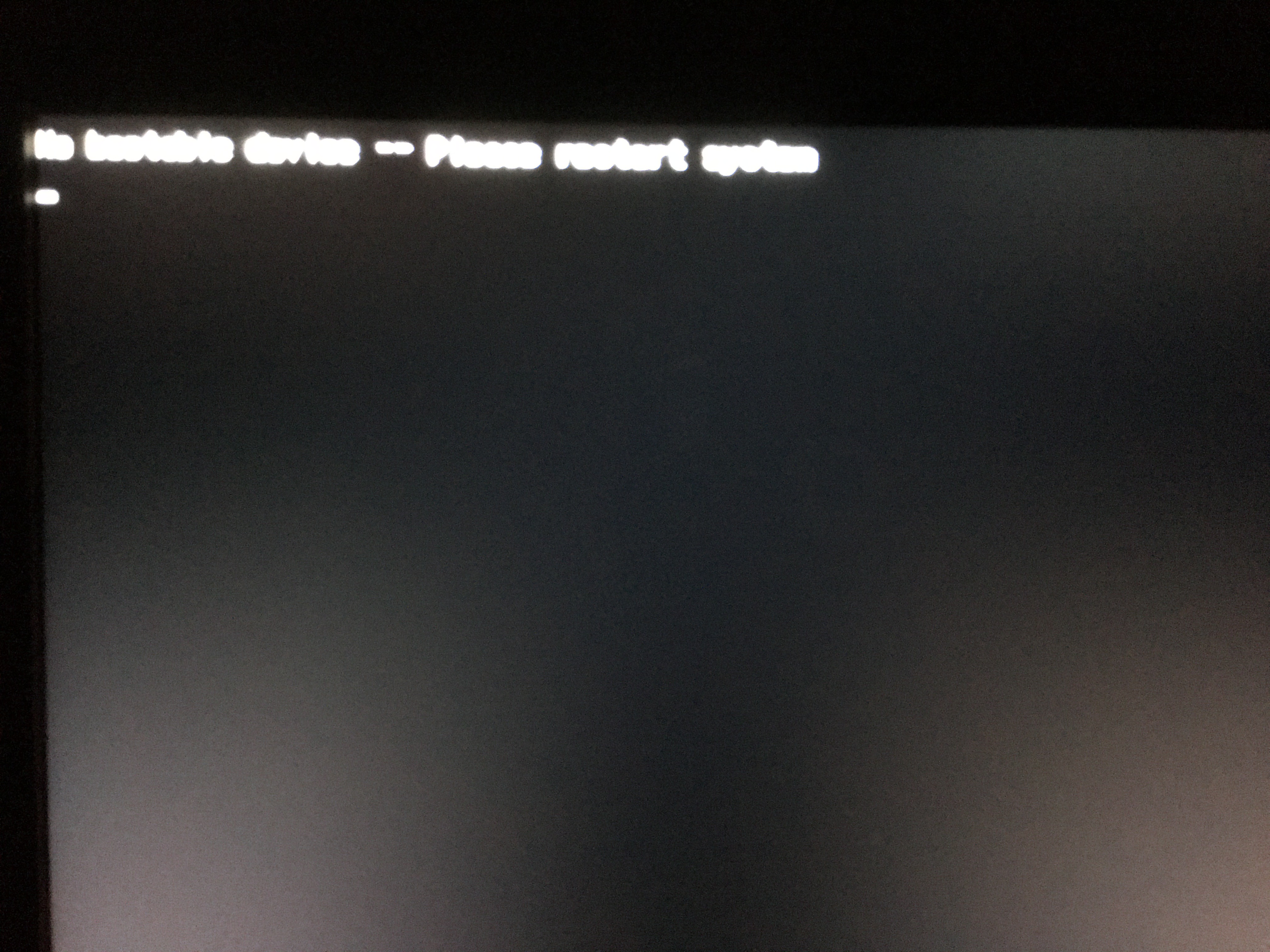

Left Framework unattended for about an hour. It should have put itself to sleep. It was unresponsive. Opened the lid and saw this.
Clicked Ok and got the same thing you see in the first picture posted. Power cycled and it booted quickly into Windows 10.
Does the same thing happen if you leave the lid open, in either Linux or Windows?
It feels like what’s happening is that the SSD is overheating and is shutting off for safety (hence the laptop can’t find any boot devices). The main way the Framework stays cool is by venting air up through the hinge (IIRC). If you’re leaving it closed and there’s signficant activity, that might bring the internal temperature up without any easy way to cool it back down.
@Framework Does that sound about right?
I left it alone for about an hour. It put itself to sleep without any intervention from me. Instead of finding it asleep, I found it at the empty Boot Manager. Power cycled it and logged in. Thanks to Word’s autosave, I didn’t lose anything.

We believe we have root caused this to an SN850 firmware issue on some version of the firmware. Updating the SSD firmware has resolved the issue in each case we have come across: My system is rebooting to a “Default Boot Device Missing or Boot Failed” message

I open the lid to it rebooted, and a message. Pic as soon as I figure out how. :slight_smile:
Default Boot Device Missing or Boot Failed. Insert Recovery Media and Hit any key
Then Select 'Boot Manager to choose a new Boot
[Ok]
