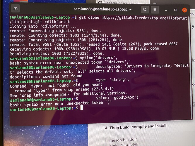

Thanks @Fraoch! I’ll run it again when I get home from work in a few hours. It may very well be user error, I was just copying all the code into the terminal. So I wouldn’t be surprised if I misunderstood and missed a step somewhere.
So I ran it again and for some reason compiling the newest version of libfprint. This is what displayed after running that part of the code:
Now I seem to be getting hung up on editing meson_options.txt. I tried running the code and got this:
I even tried entering the nano meson_options.txt which brought this up, but I couldn’t figure out if I could do anything with it.
I tried moving on to build, compile and install it seemed to install one file but not the other:
And when I tried installing the newest version of fprintd I got this:
Here’s the all of the code copy/pasted:

OK your first post is probably why your second post is failing.
You missed a command - “nano”. I went back through this enormous thread and back in post #36 or so I see where it asks you to:
nano meson.txt
nano is a minimalist command-line text editor. It’s actually pretty elegant once you get used to it but it’s proably mystifying the first few times you use it.
The command is asking you to use nano on “meson.txt” and paste lines into it. You’re not in nano, you’re just pasting these lines into the terminal. These are not commands so it doesn’t know what to do with them and gives you errors.
One of your photos does show you got into nano. Just look around for the text the directions indicate and paste. To get out of nano there are hints at the bottom: CTRL + X. It will ask you if you want to save Y / N then you have the ability to edit the file name.
