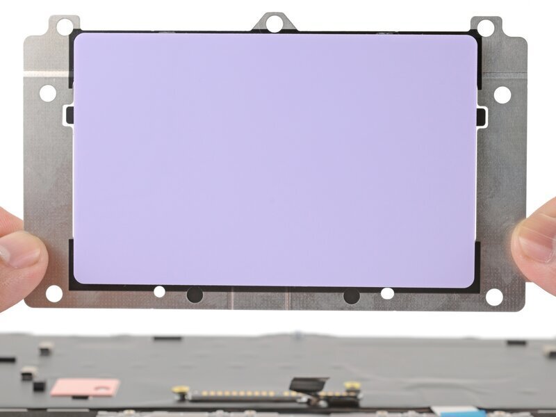

It is probably dragging on the side. Mine felt similar to that out of the box. It’s not ideal to have to mess with it on a new machine, but if you are willing to try to center it better yourself, I bet you can get it working better.
This is what mine was like as well.
It was really simple to fix, just unscrewing the seven (?) screws, shifting it a little, then re-tightening, and it all works fine now.

Just reporting my trackpad was a bit wonky on arrival (batch 10.)
Just undid the seven screws, lifted it up, moved it a little tiny bit, reinstalled with even pressure, and works a lot better now.

Main problem is the trackpad on my unit was deep on one corner compared to the other. So clicks weren’t always registering correctly and did not feel right to click once in a while. Since realigning it works perfectly fine and is a nice even surface when doing clicks anywhere.

I loosened all the screws around the trackpad, then pushed it toward the keyboard and made sure it was central. Works perfectly now.
Just FYI if you loosen the screws and it doesn’t seem to really move then you forgot a screw, there is one in the center middle at the top or bottom that needs to be loose too. It should obviously move. Not a hard fix.
