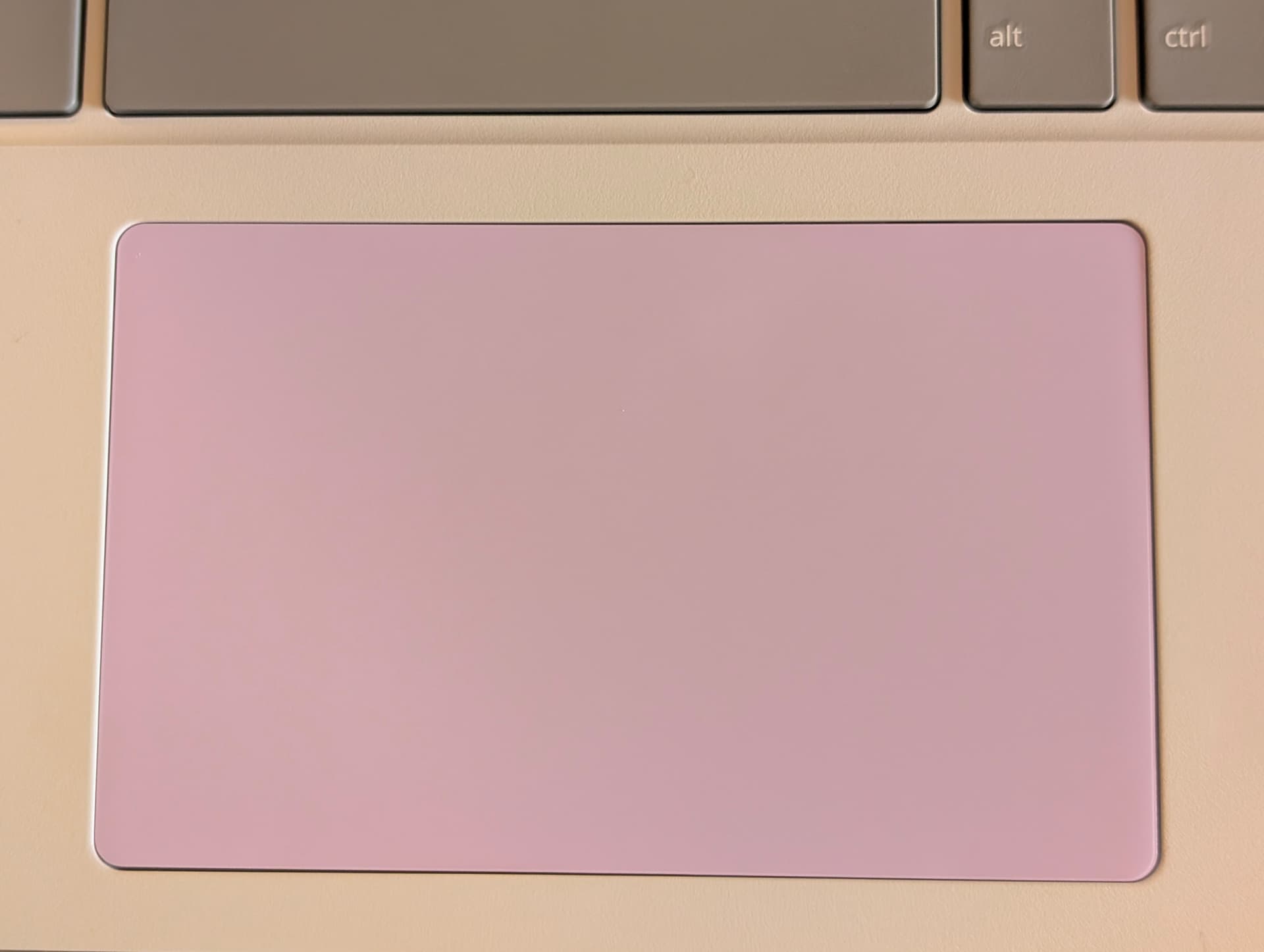

My FW12 (Batch 6, Lavender) arrived with a misaligned trackpad. How common is this? It’s not terrible, but it’s front-and-center so it was a bit of a disappointment.

Mine was a bit misaligned too. It’s relatively easy to adjust. There are 5 or 6 screws holding the touchpad to the input cover. Try loosening the screws just enough that the trackpad isn’t “loose,” but can be shifted with slight force. Then you can shift it around to where you want it and then tighten the screws.
Not great to have to do it yourself, but at least it’s possible and not terribly difficult to fix.

Looking at the photos, not only are the trackpads misaligned, but also not on a parallel plane with the palm rest / input cover. It’s tilted slightly.
