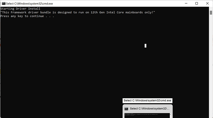

Unable to install driver bundle on 12th gen
I just received my 12th gen i5-1240p laptop and when I try to install the driver bundle I get this message:
Any ideas?
@Joseph_Iacobbo could you run the command
wmic baseboard get product
and share the output? Is this DIY or Prebuilt?
This is a DIY. I will run that command once I get the wee ones to bed in a couple hours.
@Kieran_Levin

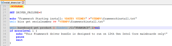

(7-zip unpack the bundle, modify the .bat file)
Oh…and you board seems to say FRANGACP instead of “FRANMACP”
Thanks, there seems to be a mixup on these in the factory. Let me fixup the driver bundle and release again
Does that mean the boards have not been programmed according to the design spec?
I did exactly this and the drivers seemed to install correctly. I no longer have unidentified devices in device manager and the touch pad is working properly.
What did you edit in the .bat file?
Change the following line
wmic baseboard get product | findstr /C:"FRANMACP" 1>nul
to
wmic baseboard get product | findstr /C:"FRANGACP" 1>nul
then run the .bat file ad administrator.
