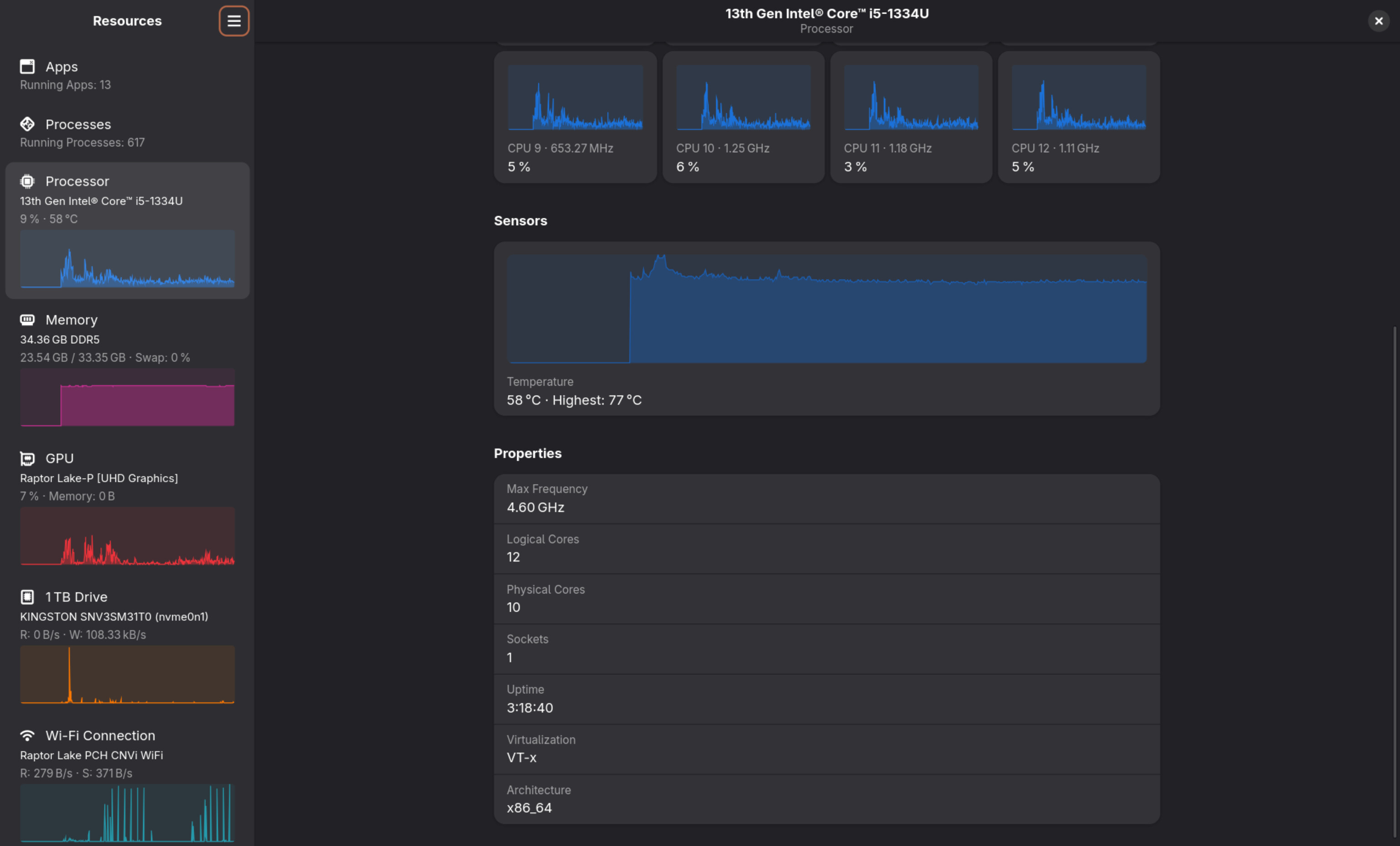

current performance indicator below:

Resources reports 58 C on CPU while framework tool reports 48, so I’m not sure what’s going on here :person_shrugging:

Could you please confirm what ram you are running? i see 34GB in the screenshots.
All of the temps I am seeing in your print out look about right. Don’t be thrown off by the TJ Max value. It is misleading. In general the FW12 runs hotter. I think some of this is the intake being so close to the exhaust. I have found that cooling is just not super efficient. I think I might try repasting mine. However that said: I am able to keep the temps around 50C normally. So things are working. I think the 12 is just designed to run a little hotter. Probably because they are trying to minimize fan noise. For this reason I am not sure repasting is something that is even needed. As of now I haven’t seen any real heat issues. I think a normal operating temp of 50+ is a bit excessive but it is within spec.

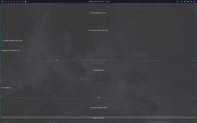

yeah I wrote a fan control application that allows you to control that. I use it primarily for the Mattbook. It works on the FW 12 though.
What I mean is that even when I manually crank the fan speed up the temps stay around the same. They are only a few degrees cooler. This is why I feel like the 12 is just designed to run a little hotter.
In this picture i am just resuming from hibernation on Omarchy. So temps are still down. Give it about 5 minutes and they will rise to the normal range of 40-50 C.

Hi, sorry for the late response, it’s actually 32 GiB, and Resources app converts it from GiB (gibibytes) to GB (gigabytes).
