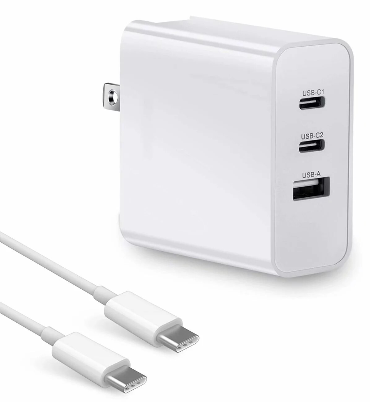

What advantage does the FW official charger has over the aftermarkets?
While I really like this company, I haven’t picked up the official charger, because I want a plug like charger.
(tried hard to find something not with a brand name to display here)
SO I am curious, if there’s any advantage of the official charger that can outweight the cons?

It sounds like you want a “wall wart” style charger that plugs directly into the wall and has a USB-C cable from there. In that case, there’s no reason not to get a charger separately. As others have alluded to, I’d recommend a quality charger, but as long as it conforms to the USB PD standards, it should work just fine.
