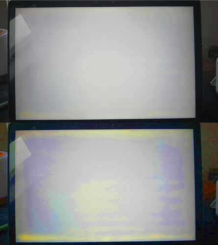

Yellow spots on display
I just noticed these maybe a week ago and was wondering if anyone else has them.
They show up really well on a white background but they’ve gotten so bad that I just started noticing them on any color.
It’s not super visible in the photos but a bright spot can be seen in the center of the left corner which is something putting pressure on the display from behind. I know this because when I close my lid slowly the white spot disappears. The spot also corresponds to the plastic guides for the antenna cable found in the top cover.
If the display sits at more than an 80 degree angle from the keyboard there will be pressure on the display enough to cause these marks.
If I apply pressure with a finger to the yellow mark it temporarily becomes normal again. It also completely goes away when the laptop is closed for a while, only to return shortly after its been opened again.
I’m fairly certain it can’t be fixed as I’ve tried reseating all the screws that hold the display assembly together to various amounts of tension. It didn’t make it any better
I’m torn on whether or not to submit another ticket to support after all the problems I’ve had with them and the machine. I may just try to ignore it unless it gets worse. (It’s already really annoying though.)

Update:
I noticed that it’s starting to spread to the middle and edges of the screen as well. Not just the bottom corners.
I turned up the saturation of the photo so it can be better seen on camera.
The spots are much more obvious in person.
I’m starting to suspect it’s caused by the pressure of my hand while drawing or just where ever there happens to be tension on the display. When the display is gently bent (as it would be while drawing or note taking) it distorts the colors and turns yellow.
My theory is that extended use with a stylus on a flat surface will cause the screen to essentially decay over time due to all the pressure. The other 12 in my house does not have these issues but it’s not used every day for drawing either.

I got a new display in from Framework and it’s completely clear of any yellow spots.
Which has made me realize that this has been a problem longer than I thought. I thought tiny yellow spots were normal and just because the display was kinda bad. Nope, This one is perfect.
I’ve had yellow spots on my display for a while now but I only posted about it when it became distracting. Gonna keep a close eye on this display and see what happens after I’ve been drawing on it for a while.
