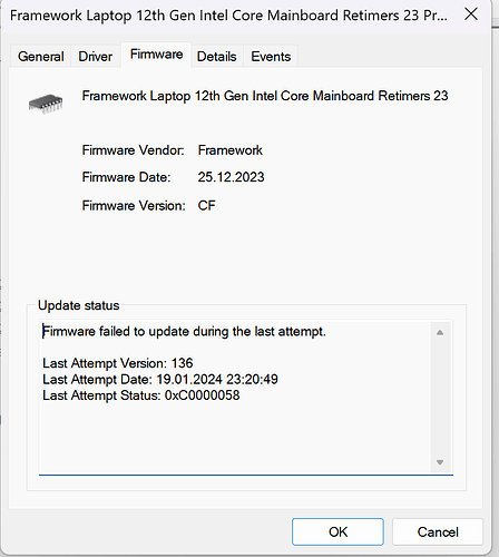

I have installed the update, in general it seems to have went fine, but upon restart the “please wait while we are installing updates” and framework logo sometimes appears for a brief moment. In device manager I see the following about Retimer 23:
Would reinstalling the 3.08 bios be a possible fix here?

I’d say there’s no harm in trying.
I tried to run the update again just to see what will happen. Both 3.08 and 3.08b will run, but after reboot I get dumped right into Windows, without seeing any update progress bars. I don’t know if the updater detected versions already current, or after the initial run they left some flag in Windows and refused to run again because of that.
I don’t have the expertise dissecting into the .msi package, nor the time to wipe/swap the SSD to see if the updater will run again. But you can probably try to run it again, see if that resolves your retimer issue.
Just tried that a while ago, it indeed ran very quickly and there were no progress bars. The device manager entry about the retimer changed though. It now shows the firmware as up to date, but it insists that the device cannot start.
Interesting. Considering putting this into a support ticket if you wish.
Do you have spare SSD to swap in (or able to wipe your current SSD) to try if the installer will re-execute more completely in a fresh copy of Windows? If you try this please keep me updated, I’m also curious. (If you swap SSD, careful with BitLocker)
Another way is trying the (currently pulled but can be found) EFI Update method and see if that fixes it.
What Expansion Cards you have? Perhaps try running the update with no expansion cards?
If you dare, 3.06 is also something you can play with.
These are the options that I would consider if I encounter this issue, try them at your discretion.
Indicates the update failed to install somehow and Windows keeps retrying. Happened to me with the 3.06 Beta as well (one of the retimers). As they announced on that Beta update: unpower device completely for a few minutes and retry. Worked for me back then and at least publicly we saw nobody permanently bricking their device or retimer and in the end, retry after cold-power-up worked.
The MSI only directly installs the ME firmware (no matter if it is already up-to-date) and hands Windows the main BIOS image, and both ReTimer firmwares for Windows to give the UEFI if Windows decides that the firmware is not already up-to-date. So reinstalling the MSI should make no difference. Either Windows knows the firwmare is not already installed and will retry on its own, or Windows at least thinks it is already installed and will ignore what the MSI does (except for the ME firmware which is directly flashed and not via UEFI capsule method as the others are).

I can share that I managed to resolve the issue by digging in the 3.06 beta thread. The following suggestion helped: 12th Gen Intel Core BIOS 3.06 Beta - #54 by chutwig
I uninstalled the retimer 23 device and ran the 3.08 msi again. This time the system rebooted and applied a firmware update again. After rebooting to windows, the retimer 23 reports no issues. So far all ports are functioning, I will test with a TB3 device today as well.
Glad to hear you were able to resolve your issue!
I think in the non-Beta release, it would be beneficial if Framework add the option of forcing a complete re-update, to resolve failure cases like this.
