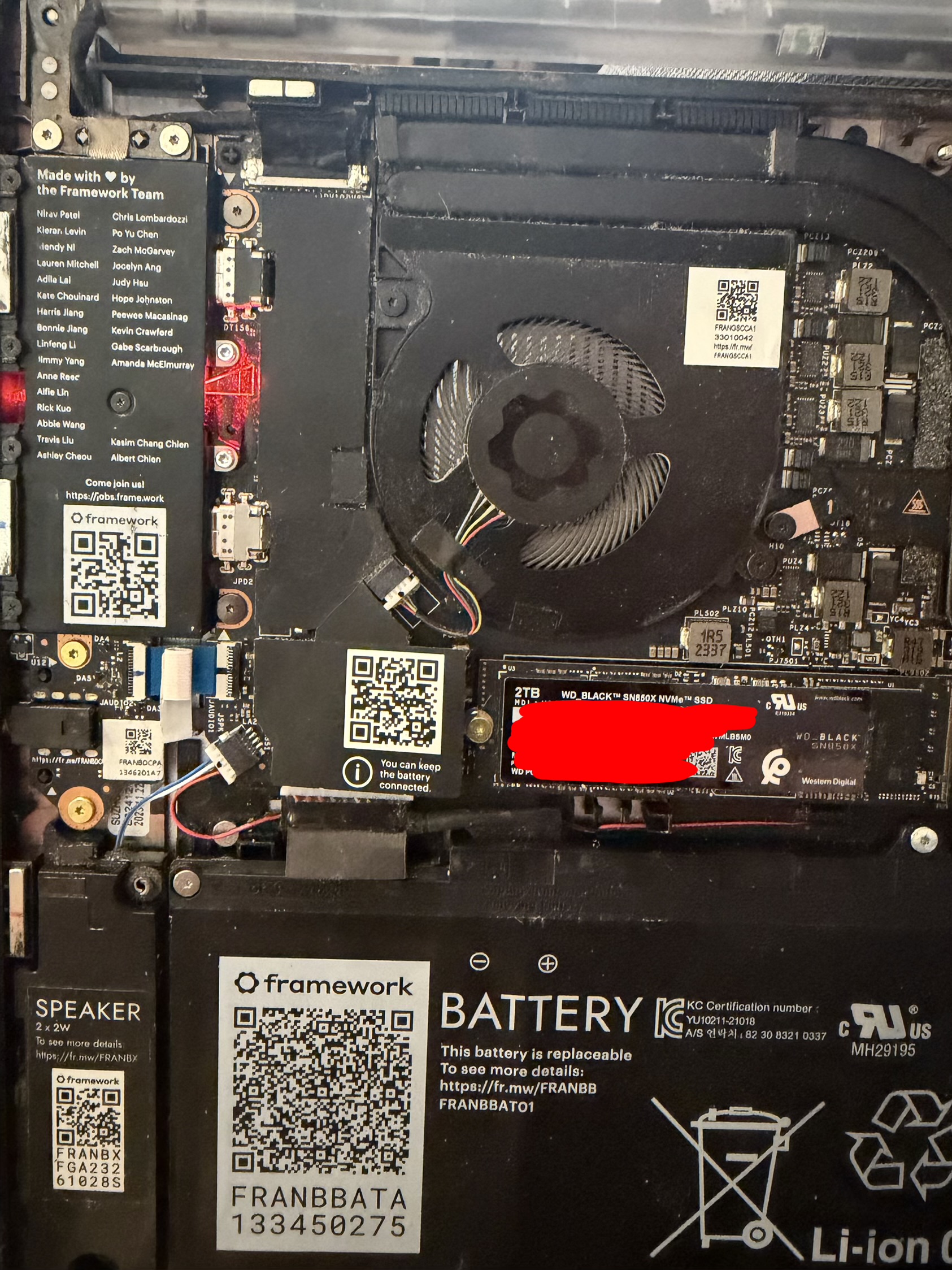

Here’s a photo of the internals. Also added a photo of the audio cable since I suspect it might have something to do with that as well.
I’m not sure why you think the input cover is relevant, the lid sensor sits on the chip that has the audio port on the left between the speaker and the expansion ports.
The most likely cause is either something magnetic near the audio board, or maybe a short cuircuit in that audio cable, which looks a bit bad from your photo.
