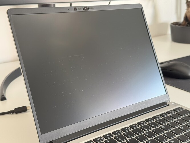

Having the same issue, have a look:
The display was cleaned with a microfiber cloth before. (No usage of harmful chemicals, only a bit of water)
Will ask the support about it.
Having read about those keyboard imprints on the screen before purchasing my Framework 13, I immediately put an adhesive polyurethane dot (6 mm in diameter, 0.5 mm in height) on each upper corner of the bezel. These transparent dots are hardly visible, and, no marks on the display so far.
