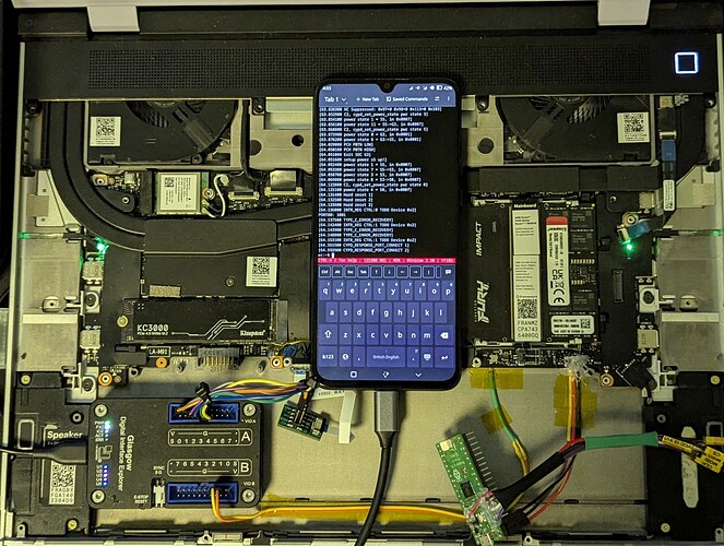

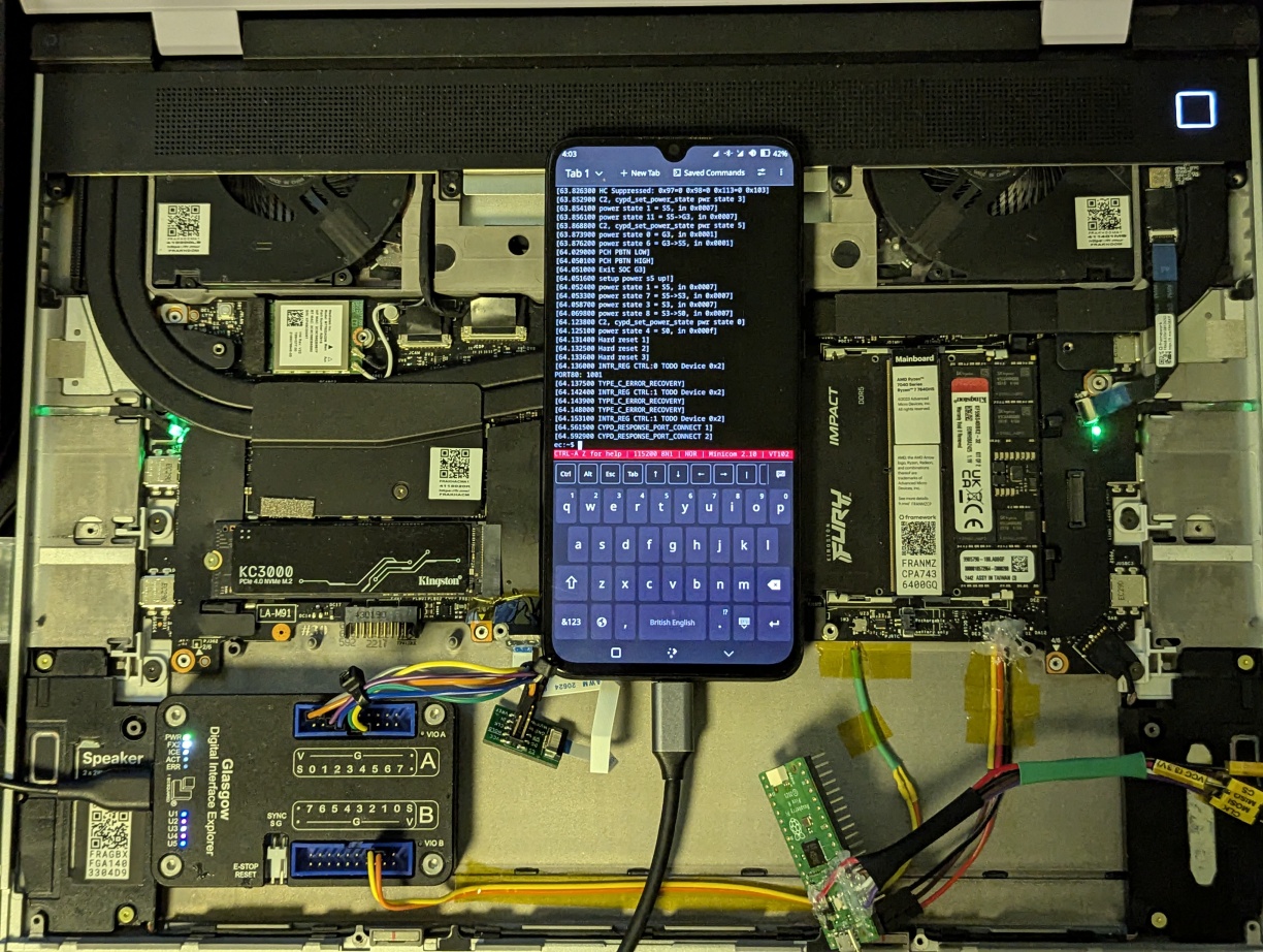

Like I mentioned in this thread: No, JUDC connector is useless unless you’re doing active firmware development (and even then according to some people upper-left USB-C port apparently has SoC UART exposed, I didn’t have resistors necessary to make PD controller mux those pins so I didn’t verify it),
If you want to re-flash the SPI flash the easiest way is to poke it with a probe. There’s a JSPI connector near the SPI flash, but it doesn’t have necessary resistors and VCC pin isn’t exposed.
Here’s my current setup, I hope Framework’s engineers won’t send assassins to my house after seeing what I’ve done to their child.
