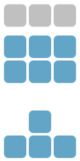

One feature that I would really like to see on the Framework 16 is full sized arrow keys, not the half sized keys currently offered.
I propose that this could be achieved by putting the down, left, and right arrow keys on the track pad module. That would allow for what is currently the up and down arrow keys to be replaced by just an up arrow key. The current left/right arrow keys could be replaced with page up and page down.
This could be sold as a trackpad input module that includes keycaps to replace the keycaps normally on the keyboard module. This would allow for compatibility with all existing keyboard input modules while only requiring one new SKU.

First though, I like it!
Unfortunately, subsequent thoughts that pop into my mind are reasons I don’t think it will work… :melting_face:
Including what seems to be a dealbreaker. There are tracks that take up the space under where it seems you placed the arrow keys.
Nrp said the trackpad module uses a “different interface”.
From something said elsewhere I suspect it might be i2c instead of usb. If this is the case, it could make custom modules for the Touchpad area no longer straight forward.
You might feel it works fine & is worth the risk of breakage, but I wouldn’t expect Framework to agree. You might have had good luck, perhaps skill, in removing laptop keys without damage, but others aren’t so lucky. If I recall, one person who did it on the Framework-13 to create a mixture of transparent & non-transparent keys mentioned breaking a few in the process.
This is unlikely to be possible mechanically. However what would be possible is building a Medium size Input Module that has the navigation cluster on it as an alternative to a Numpad. This would be within reach of community development as well.
The angle of the photos makes it hard to tell, however I think it looks like those barely extend upwards so there may be enough room.
When I receive my batch 1 Framework 16 I will hopefully be able to measure the clearance issues of those and report back here.
Edit: When I wrote this I hadn’t yet seen that @nrp replied that it is unlikely possible mechanically. I’m still hopeful but this probably won’t happen.
