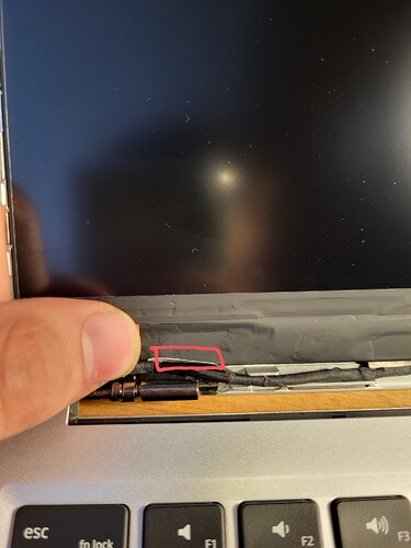

I’ve just received an AMD DIY with 2.8k screen. The display cable looks like this:
2 questions:
  1. AFAICT, the white part is an adhesive strip like the ones on the bezel. Should it be stuck to the display? I do not see it mentioned in the AMD quick start guide nor the Display replacement guide.
  2. I assume the cable nearest the foil backed side needs routing in the channel? Its currently below/outside it. This also isn’t mentioned in the guides (and the display looks different), but I did note a recent comment mentioning similar.
Thanks

  1. I’ll wait for confirmation regarding the adhesive. I recall Hinge clicks - #13 by mjnz previously, so don’t want to cause them unnecessarily. I’ve also asked support.
  2. Almost certainly it needs routing inside here:
Just thought it was strange it was shipped below.

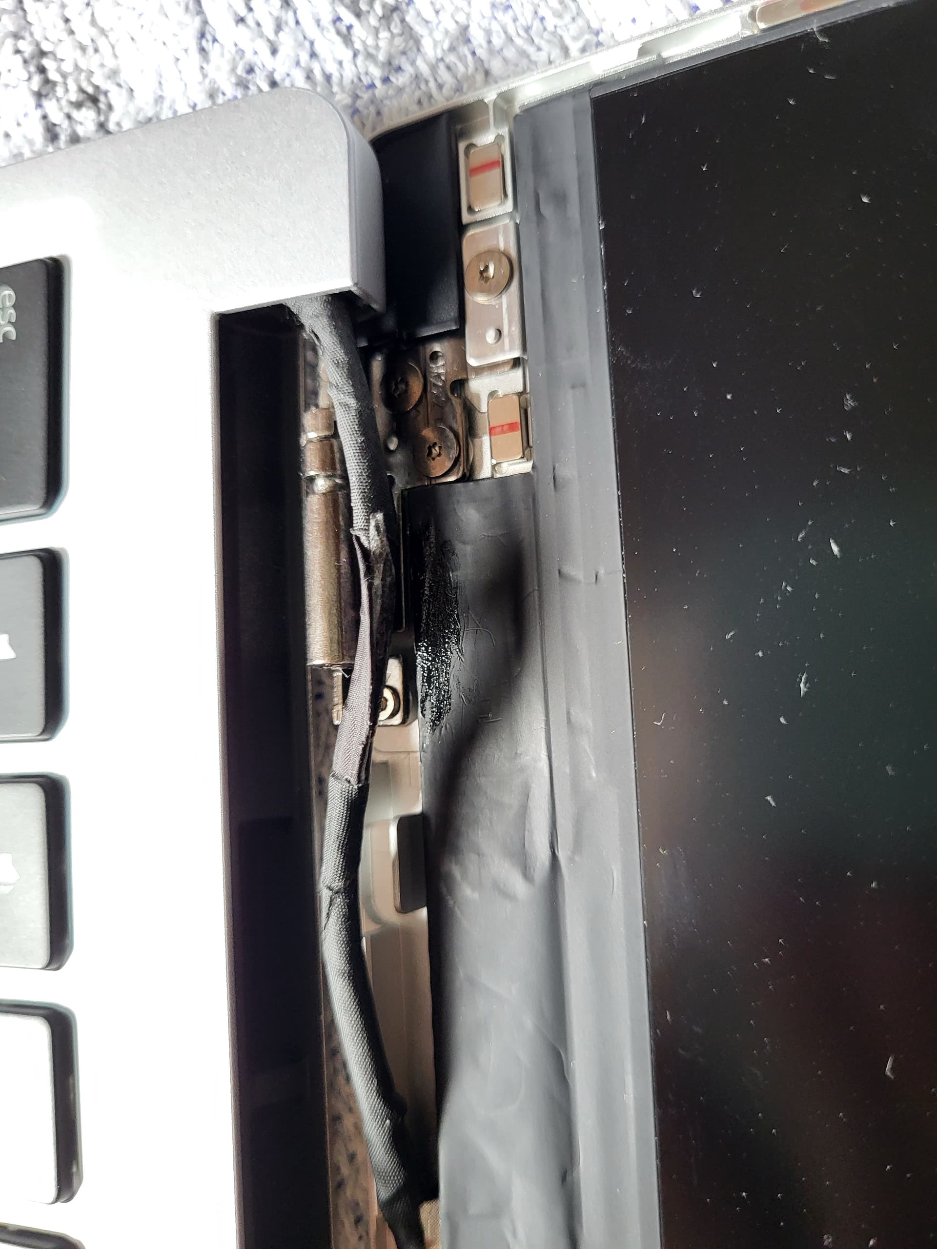

Hi I had the same issue with the cable and didn’t check carefully enough which resulted in a broken bezel :tired_face:
The support was very nice (replacement is on its way) and recommended the following guide for routing the cable.
„ We have a guide that walks you through replacing the Framework Bezel located here:
Thanks. I’ve read through that guide (and the one for display replacement), but it doesn’t mention cable routing in detail.
Does yours have the white strip here?
Yes, same strip. I was also wondering what to do with it
After 8 messages back and forth with support who could not give a definitive answer to this (besides “the display cable needs to be routed correctly”), I gave up and stuck it down per this image. Thank you.
Lucky I did - the display’s motherboard connector had partially disconnected and the silver/foil-backed tape had come away from the hinge.
Feedback to Framework: if the new screen is intended to be shipped like this (and it wasn’t a QA oversight), a specific call out in the guides would be useful.
It does not rally matter what you do to this white strip. It is emant to be sticked on the display (it was like this with my old cable). But for me when I pulled the white paper, the glue came down with the paper as well and the cable still fits needly in to those aluminium rails.

Yes, the routing is the same
is the display guide itself also valid and compatible for 2.8k display? thanks.
yes it is. Only the actual panel is different, so all the screw placements and cables are the same.
I had the same issue with the cable from the lower resolution screen. They told me that I should stick it on as marked in the image however, it came off right after I started using the laptop and the cable bumped into the inside of the bezel every time I opened the screen. They told me to reattach it many times up until the glue was barely working anymore and I just decided to return the device and just get one that is assembled correctly. They wanted me to change the display cable but I find that for a new device I shouldn’t have to do that.
