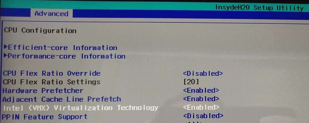

Virtualization is enabled in the BIOS

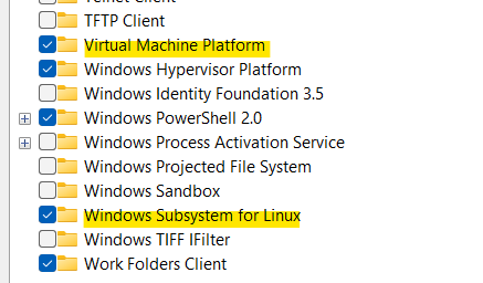

Windows features required for WSL2 and Docker are enabled.

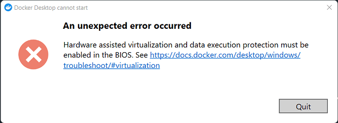

Docker and Ubunto with WSL2 fail to execute
(note that data execution protection is enabled)
Ubuntu 20.04.5
Framework support suggests this is an issue with Docker, which I find hard to agree with. Has anyone else experienced a similar issue?

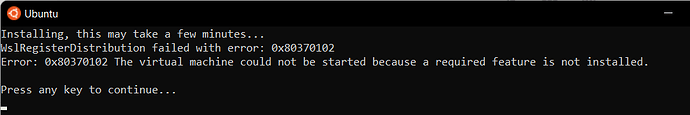

To point out, the issue is not just with Docker but with WSL2. Docker uses WSL2 to execute, and w/o it working properly, it quits. And I’ve tried everything to sort out WSL, but it fails when executed (wsl --install -d Ubuntu) with the following error:
This leads me to think there’s something off about my laptop rather than a general issue. It would be nice if others with Gen12 Framework using WSL2 could confirm or deny my assumption.

Docker is still barfing.

I uninstalled WSL and used the command line rather than Windows App Store to install it.
Additionally, enabled Hyper-V in Windows features
You missed Hyper-V in Windows features to begin with?
Yes, that was a dumb mistake on my part.
But since WSL2 is now working, I’m assuming virtualization is OK and it’s Docker for Windows that is acting up. Will try removing it and installing again, removing all the files it leaves in %appdata%/Docker after first.

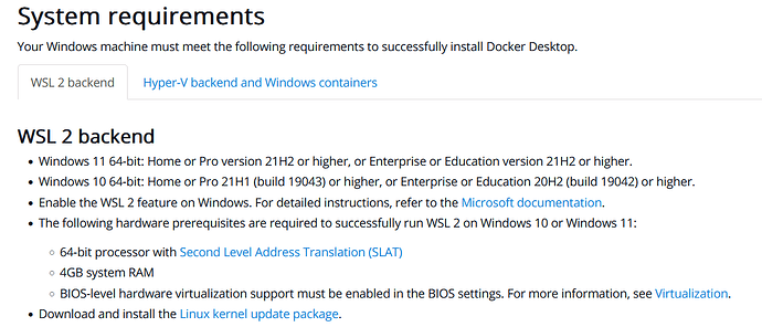

Interesting enough, the latest version of Docker shouldn’t require Hyper-V if it uses WSL2. Which, I’d think, would mean WSL2 shouldn’t require Hyper-V either.

But Docker, re-installing it didn’t help. Getting that annoying error after reinstall :disappointed:

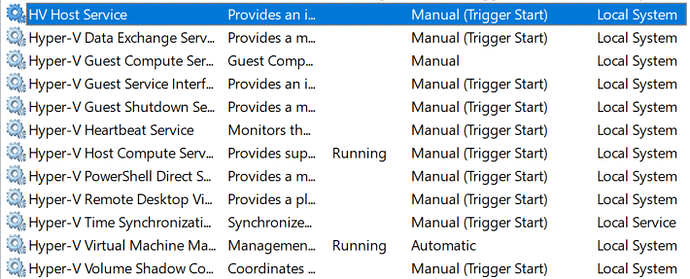

Did you check the Hyper-V services? (Hyper-V Virtual Machine Management)

No, I meant Windows services: Win+R => services.msc
There are a lot of services starting with Hyper-V and a service called “HV Host Service”.
The startype of them should be set to “Manual (Trigger Start)”
The “HV Host Service” should be running.
It matches what you’ve described

Yes. That’s a part of the default BIOS settings.
Framework BIOS is very “primitive”. There’s nothing besides VMX (turned on).
