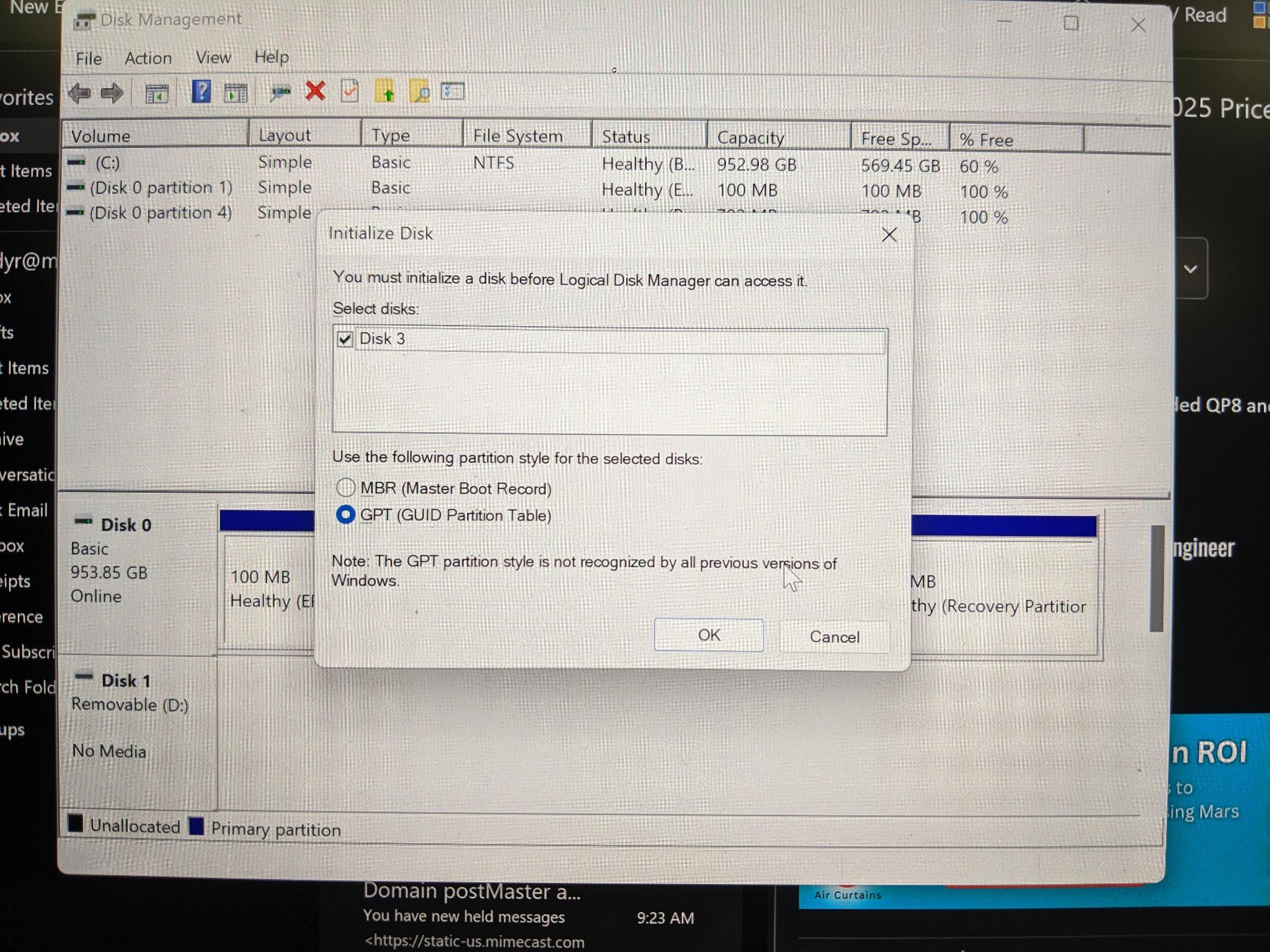

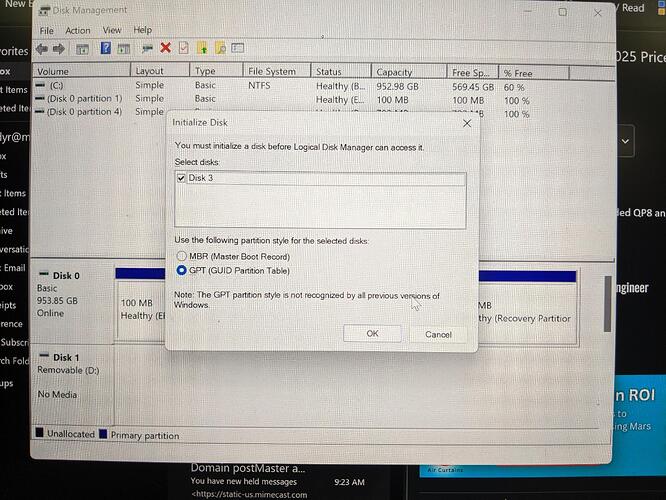

That’s what I was afraid of. You see, this is the second time I’ve experienced this exact issue. The first time was in October, when I found that the partition table on my SSD (SK Hynix Platinum P41 2TB) was spontaneously deleted - this is according to Windows Disk Management, when I removed it and connected it externally (via USB adaptor) to a second computer:
At the time, I believed I had fallen victim to the data corruption bug due to Windows update KB5063878 and Phison pre-release firmware - especially since, at the time of the corruption, I had been in the process of checking in a large CAD file, and the bug is supposedly triggered by large I/O operations. Using TestDisk on my second computer, I was able to restore the partition table (at least partly) and make the device readable - thus I was able to copy my critical data, but the device was still not bootable, nor could Windows Recovery restore the bootloader. So at that point I reinstalled Windows from scratch and updated the SSD firmware using SK Hynix’s official tool. It worked without further issue until yesterday.

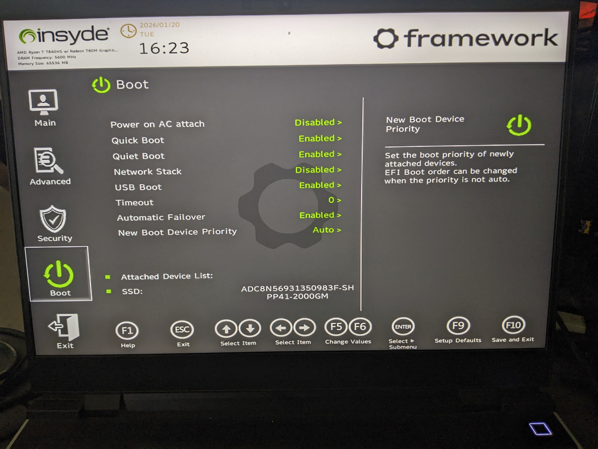

This time around, I have not yet attempted any recovery or repair steps: it still tells me that the default boot device is missing. When I look at the Boot Manager, no device is listed:

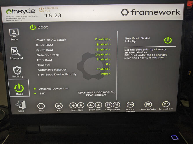

But the SSD is detected:
So I’ll bet my bottom dollar that the exact same corruption happened as last time, but theoretically, since I updated the firmware I shouldn’t have experienced the same bug. Also, this time I wasn’t performing any unusually large I/O operations (I had Word open, and had just sent a message on Teams). Any ideas on what I can do to recover without having to reinstall everything again? That was a pain last time.
