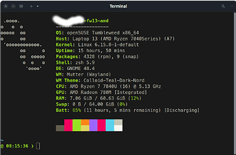

Attached snapshot showing three displays:
