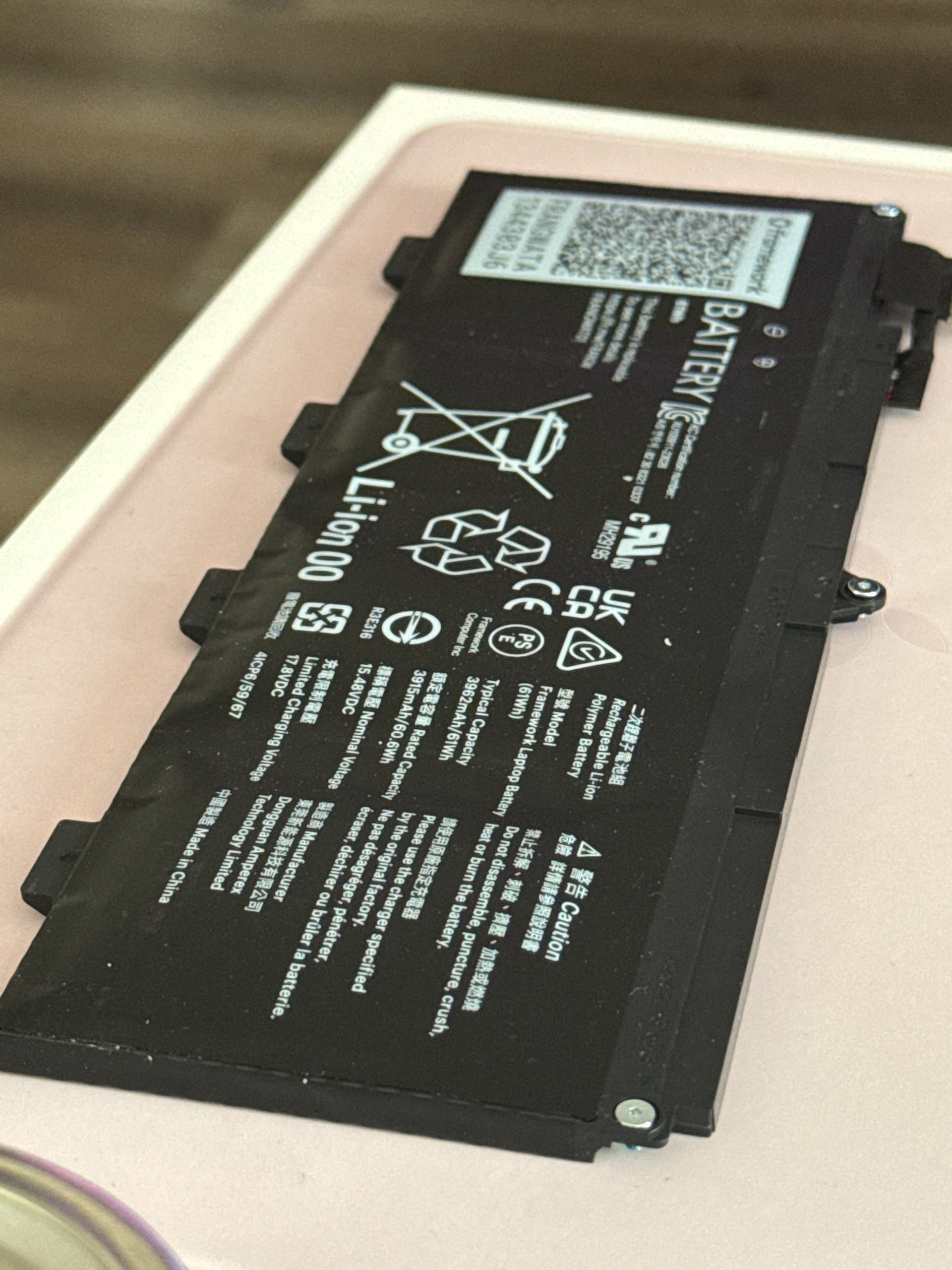

I got a Framework 13 two years ago (Apr 2024), and the battery just died. Like, dead dead. Spicy pillow dead. I’ve had tons of laptops over the years, but I’ve never had one where the battery died that quickly.
I didn’t even notice it until the fan stopped working today, and I took it off the dock to check it out, and noticed the input panel was bulging up from the chassis. I think that bulge may have pinched the fan, which could explain why it wasn’t spinning, but the sensor reported it was spinning at several thousand RPM.
I opened up the chassis and every cell of the battery is bulging. Kinda scary, considering it’s been sitting on my desk at 100% charge for a few days now.

It is generally best to keep the battery at around 70% if you mainly use it while plugged into power.
Only charge it to 100% when you know you will be using it and discharging it soon.
There are settings in the bios to do this charge limiting.
Lithium ion battery life is shortened if the battery is left 100% and if left 0%.
Contact FW support.
They might replace it for you as they had a batch of bad ones.

I would definitely get in touch with support, it is probably still in warranty even if you only had 1 year (they extended it).
So, the battery protection only kicks in if you’ve had it plugged in for more than a few days, and I just plugged it in like two days before, so it was still in the 100% charge window.
Either way just warranty it and maybe use a fixed charge limit in the future if you mainly use the laptop plugged in.
This issue is common. Mine swole and the mousepad needed way more force to click. But it still worked and charged fully. Support sent me a free replacement battery.
For what it’s worth, I am the OP of one of those threads and Framework sent me a free replacement as well.
This was shortly before the announcement of 13 Pro with the ballin’ battery, I think that may be why they replaced it with no questions asked.
I contacted support, and they said that since it’s out of warranty, I have to buy a new battery. So I guess the takeaway here is that if you buy a Framework, you might have to buy a new battery for it every two years.

I think we are getting closer to the cause of the battery issue. In addition to voltage that probably makes the 55Wh more durable than 61Wh. The main problem is very likely to be BMS calibration or programming issue.
Firstly, the charging temperature is too high, probably due to Celcius to Kelvin conversion error. The battery only stops charging at 55C but slows down to a crawl as early as 20C
It would be better for the battery health if the temperature window is moved from 20 - 55C to 10 - 45C.
Secondly, the battery charging termination current is way too low. Near the end of charging, the voltage is held constant while the current decreases. When the current is lower than a threshold, the current turns off and charging is finished.
Most laptop I have used charges from 99% to 100% in 5-10 minutes. Even for laptops that I haven’t used for months (higher BMS error that needs a full charge to calibrate), 30 minutes is the most from 99% to 100%.
In the Framework Laptop, charging from 99% to 100% may take 30 minutes to 2 hours even if the battery has been calibrated by charging to 100% yesterday, showing that the charge termination current is way too low. This is also a contributing factor to battery aging.
Now we find the culprit, the next step is for Framework stuff to relay the message to the battery manufacturer to adjust the BMS accordingly.

So, there were more issues that just the battery. None of the USB ports that had non-USB C expansion cards (a USB A and an HDMI) would work, and with the USB C ones there was that constant disconnect/reconnect when charging. I booted up into a Kubuntu live USB, and they all worked again. So I copied my entire disk to a USB drive and tried reinstalling Fedora. Now everything works again and the charging issue is gone. I’m not sure what happened, but maybe the system constantly having issues when it got too hot (it would remount the disk as read only when the NVMe got too hot) broke something in the system. Anyway, it’s all working correctly now after the reinstall, so I think we’re good.
Oh, also the fan issue was because of the battery. After installing the new one and running Furmark, the fan spun back up again.
I’ve now put a hard limit on the battery charge in the BIOS to 85%. It sucks that I don’t get that extra 15% of battery, considering the battery life is already pretty terrible, but I’d rather have to find an outlet more often than have to buy a new battery every two years.

I’ve got the same bulging 61Wh battery pack pushing up the input cover.
It does hold a charge though, for a decent amount of time too. I only noticed it because the input cover bulge became obvious.
Age is around 1.5 years, not even 2 years yet.
I updated the firmware that was supposed to fix the charging issue almost as soon as it came out.
I also seem to have the fan not working issue, which explains why my laptop has been noticeably hotter for about a month, maybe two.
Oh well, I contacted Framework support for assistance.
Your battery is still within warranty so you can replace it for free
The battery degradation/swelling is also caused by a low charge termination current (long 99% to 100% charge time)
Check your cooling system, a dead fan can cause heat spreading from the CPU to the battery, damaging the latter
