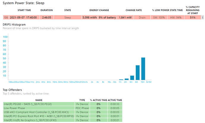

FYI if you want a deeper look into what is draining power during standby, run a SleepStudy as described by Nirav here.

Unfortunately after running the installer (twice) it looks like I’m still getting the same drain rate from the audio controller:
I saw in the changelog that the fix is coming from the addition of Intel Smart Sound Technology, but I’m not seeing any indication of it running. Not sure I’m looking for it in the right places though–a quick Google search says that it should appear under Device Manager > System Devices but I don’t see it there.
@jeshikat Do you get any notifications or tray icons that say SST is running? Any SST device in your Device Manager list?
Thanks for the response @RandomUser. There are no SST devices listed in Device Manager for me. Here is the contents of the frameworkinstall.txt file:

Like @RandomUser, the only other red I’m seeing in SleepStudy is NoHwDrips.C10.Unknown. No idea what it means though.
