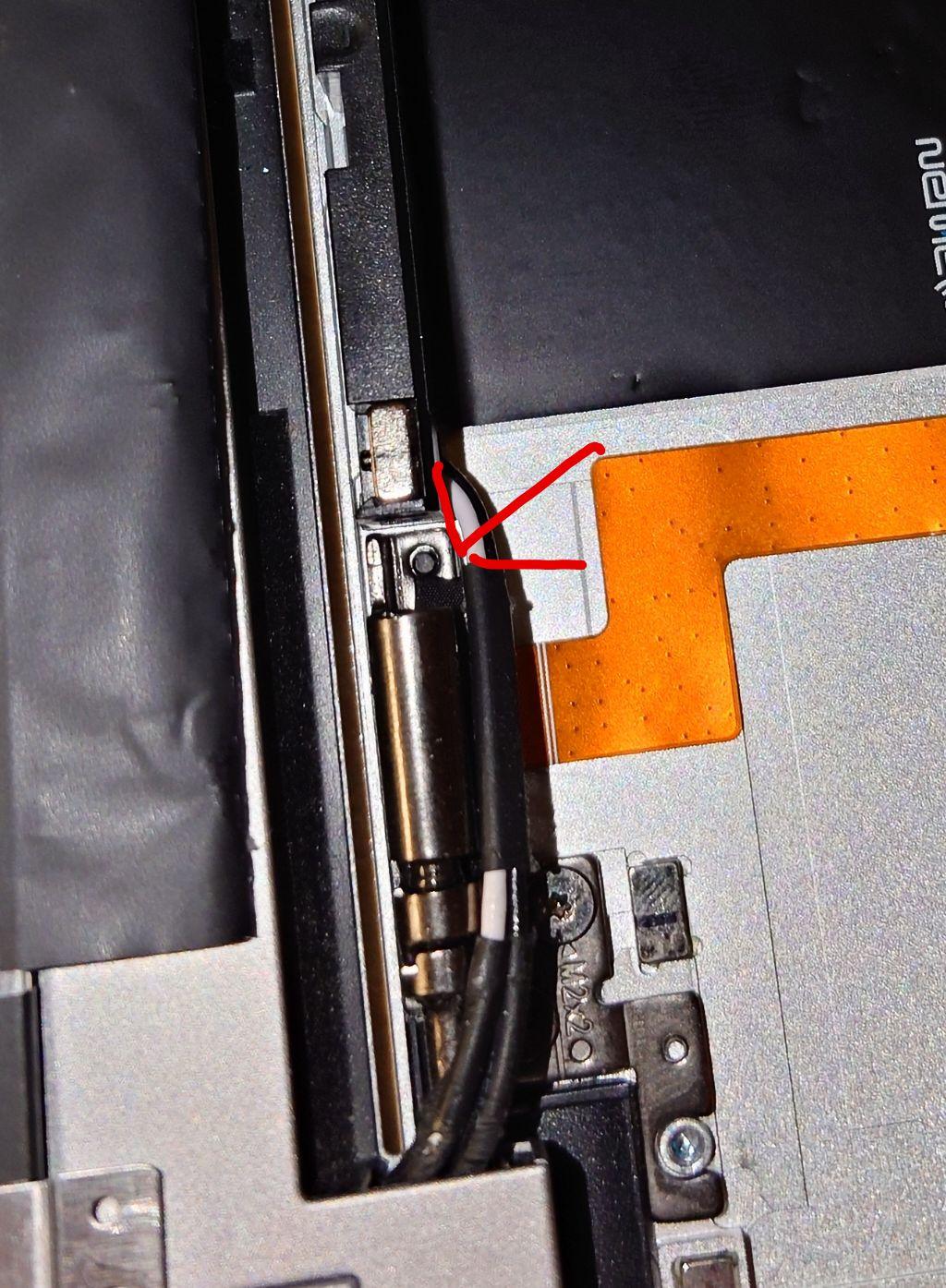

I was installing my upgraded display kit and noticed that there were two small screw heads clinging to the magnets on the lower bezel area. Upon closer inspection, it seems these screws have been sheared off by the hinge. The hinges were replaced ~2 years ago with the heavier hinges, and the laptop has been used daily since then. Is this fine? It feels OK, but I am worried that increased load could rip out the other screws. Has anyone else had this problem? I would like to avoid the MSI™ authentic experience if possible.

I ran into a similar problem on my 12th gen Intel. The lid on my Framework 13 became very floppy and while replacing the OG hinge on the left of the laptop I found that it was leaking grease. After removing the hinge the 3rd screw closest to the middle of the laptop had it’s screw head snapped off. The hinge replacement went fine but it’s obviously not easy to replace the screw in the lid without figuring some way to remove the broken screw.
How did you manage to remove the broken screws ?
I just received my set of 4kg hinges and discovered the left small screw was broken. I tried to solder a piece of cable to it to be able to unscrew it but it did not work.
I reassembled my laptop without that screw… but I would feel safer with it.
I left the broken screw and like you just reassembled with using only 2 of the 3 screws for the left hinge.
It doesn’t seem like it’d be easy to fix that without replacing the lid, which is something that I might do in the future.
That being said, the lid still seems to be holding up okay without this one screw, so as long as you’re not terribly rough opening the lid you might be okay.
