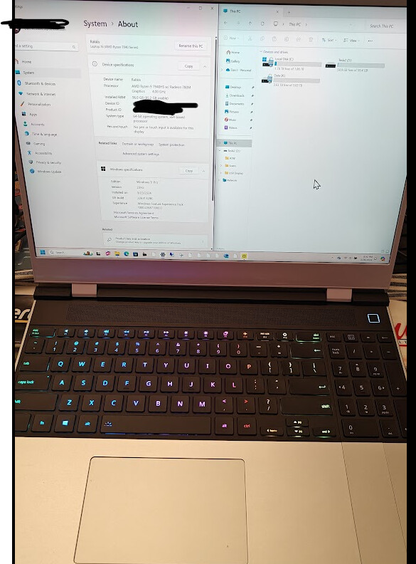

Yup - my LAST laptop :crossed_fingers:, so I went :crazy_face: with all specs (I did buy my own M.2s and RAM - can confirm that 2x48 GB work just fine.)
THANK YOU @MarkRendle and to @VeSeAr I fixed the whole problem as well. Same here, it detached after I disconnected the other end and all I had to do was to put the latch down and reconnect it! Replacement is on its way as well -so I will use that when it arrives . Seem that this is a weak point and Framework should be aware and make sure that is done properly on the assembly line! I had to reinstall the drivers pack as the fingerprint reader was no longer seen.
